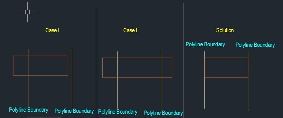

John Camper Posted June 17, 2023 Share Posted June 17, 2023 Hello, I have two polyline as Boundaries and a Rectangle . The case is that the rectangle length must not exceed the polyline Boundaries on both sides nor be less than those polyline Boundaries distance on both sides (ie Rectangle length = Two Boundaries Distance) . Is there any lisp through which it can be achieved ? Quote Link to comment Share on other sites More sharing options...
Tharwat Posted June 17, 2023 Share Posted June 17, 2023 I believe using the stretch command would be faster and fewer step inputs than any custom program if the case is just like that. Quote Link to comment Share on other sites More sharing options...
marko_ribar Posted June 17, 2023 Share Posted June 17, 2023 (edited) Here, help yourself... (defun c:polyboundrect ( / ss s1 s2 rect rectx b1 b2 x1 x2 pl p0 p1 p2 p3 ) (prompt "\nSelect LWPOLYLINE or LINE BOUNDARIES and RECTANGLE LWPOLYLINE...") (if (setq ss (ssget "_:L" '((0 . "LWPOLYLINE,LINE")))) (progn (sssetfirst nil ss) (setq s1 (ssget "_I" '((0 . "LWPOLYLINE") (-4 . "&=") (70 . 1) (90 . 4) (-4 . "<not") (-4 . "<>") (42 . 0.0) (-4 . "not>")))) (sssetfirst nil ss) (setq s2 (ssget "_I" '((-4 . "<or") (0 . "LINE") (-4 . "<and") (0 . "LWPOLYLINE") (-4 . "<not") (-4 . "&=") (70 . 1) (-4 . "not>") (90 . 2) (-4 . "<not") (-4 . "<>") (42 . 0.0) (-4 . "not>") (-4 . "and>") (-4 . "or>")))) (sssetfirst) (setq rect (ssname s1 0)) (setq rectx (entget rect)) (setq b1 (ssname s2 0)) (setq b2 (ssname s2 1)) (setq x1 (car (trans (cdr (assoc 10 (entget b1))) (if (= (cdr (assoc 0 (entget b1))) "LINE") 0 rect) 1))) (setq x2 (car (trans (cdr (assoc 10 (entget b2))) (if (= (cdr (assoc 0 (entget b2))) "LINE") 0 rect) 1))) (setq pl (mapcar '(lambda ( p ) (trans (list (car p) (cadr p) (cdr (assoc 38 rectx))) rect 1)) (mapcar 'cdr (vl-remove-if '(lambda ( x ) (/= (car x) 10)) rectx)))) (setq p0 (car (vl-sort pl '(lambda ( a b ) (if (= (car a) (car b)) (< (cadr a) (cadr b)) (< (car a) (car b))))))) (setq p1 (car (vl-remove-if-not '(lambda ( x ) (= (cadr x) (cadr p0)) (> (car x) (car p0))) (vl-remove p0 pl)))) (setq p2 (car (vl-remove-if-not '(lambda ( x ) (= (car x) (car p1)) (> (cadr x) (cadr p0))) (vl-remove p1 (vl-remove p0 pl))))) (setq p3 (car (vl-remove p2 (vl-remove p1 (vl-remove p0 pl))))) (if (< x1 x2) (progn (setq p0 (trans (list x1 (cadr p0)) 1 rect)) (setq p1 (trans (list x2 (cadr p1)) 1 rect)) (setq p2 (trans (list x2 (cadr p2)) 1 rect)) (setq p3 (trans (list x1 (cadr p3)) 1 rect)) ) (progn (setq p0 (trans (list x2 (cadr p0)) 1 rect)) (setq p1 (trans (list x1 (cadr p1)) 1 rect)) (setq p2 (trans (list x1 (cadr p2)) 1 rect)) (setq p3 (trans (list x2 (cadr p3)) 1 rect)) ) ) (setq rectx (append (reverse (member (assoc 39 rectx) (reverse rectx))) (list (cons 10 p0) (cons 10 p1) (cons 10 p2) (cons 10 p3)) (list (assoc 210 rectx)))) (entupd (cdr (assoc -1 (entmod rectx)))) ) ) (princ) ) M.R. Edited June 17, 2023 by marko_ribar 2 Quote Link to comment Share on other sites More sharing options...
