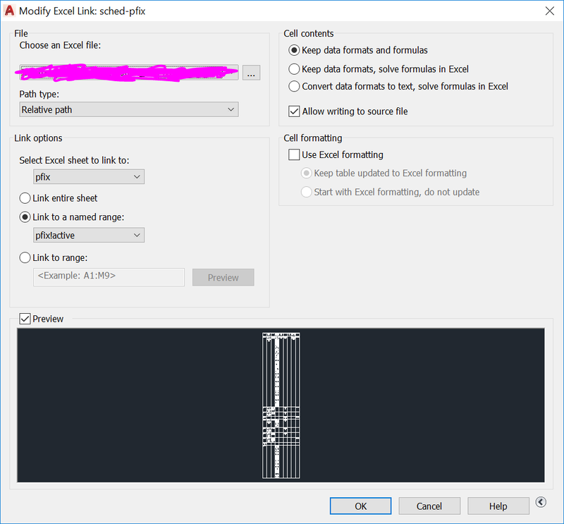

Hi everyone, is there a way to transmit an hyperlink in an Excel cell into an AutoCAD table? I have successfully (surprisingly) set up data links but I'd like to get Excel hyperlinks to transfer as such, then come out active in a published PDF.
In the Data Link manager, I've tried all three Cell Contents options but none convey the hyperlink.

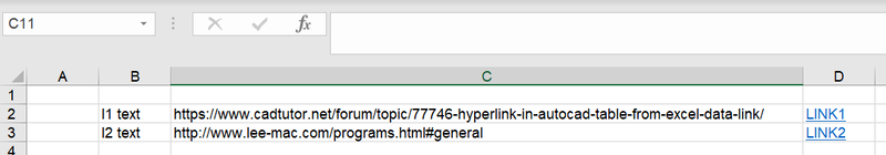

BIGAL, thank you for taking the time. I edited a line of the code above as follows:
(setq desc (vlax-get hyp1 'textToDisplay)
to avoid the error: "; error: ActiveX Server returned the error: unknown name: "TEXTODISPLAY""
This is the result with Excel set up with two hyperlinks:
Given your input, I think I'm going to shoot for Plan B - convert hyperlinks within AutoCAD table text objects into fields with hyperlinks.
Yes fixed typo missing "t" thanks.
The code at moment only gets hyp 1 so hyp 2 would get Link2, that is why I hinted need to compare the hyperlink to description to find match.
