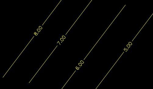

Hi, I am trying to change the text height by the giving scale using a ht parameter , but I can not find In the code  where  the text height change. Can any one help

This line creates the text:
(setq Obj (vlax-invoke Space 'AddMtext P 0.0 (rtos Elev 2 2)))
searching about on the internet should give you solution and explanation,
Add something like this on the next line, where ht is your text height - might need to alter the position of the text height line to make it work
(vla-put-textheight obj ht)

Hi mhupp. I add this line
but i didn't see any difference , the text height didn't change
Thanks
@mhy3sx Give this a shot and let me know. :)
NOTE: Yo can press enter to accept the default scale factor or enter your desired one.
