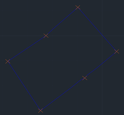

RepCad Posted June 14, 2023 Share Posted June 14, 2023 (edited) Hello everyone, I'm using GetPoint in a loop to specify and I'm willing to disply a temporary point or mark on screen while user picking points on the polyline. (I mean do it without entmake or add point) Is it possible to implement it via AutoLisp ? I mean something like the attached image, suppose all the points are temporary and picking by users on the polyline. Edited June 14, 2023 by RepCad Quote Link to comment Share on other sites More sharing options...
devitg Posted June 14, 2023 Share Posted June 14, 2023 (edited) @RepCad please upload dwg and lsp Maybe some GRread , Edited June 14, 2023 by devitg add note Quote Link to comment Share on other sites More sharing options...
Tharwat Posted June 14, 2023 Share Posted June 14, 2023 Here is one way to use grdraw function to create temporary rubber band. (defun c:Test (/ ins lst tmp len) ;;----------------------------------------------------;; ;; Author : Tharwat Al Choufi ;; ;; website: https://autolispprograms.wordpress.com ;; ;;----------------------------------------------------;; (while (setq ins (getpoint "\nSpeicy point : ")) (setq len (* 0.5 (/ (getvar "VIEWSIZE") 10))) (foreach pt (setq lst (cons ins lst)) (setq tmp (* pi 0.25)) (grdraw (polar pt tmp len) (polar pt (setq tmp (+ pi tmp)) len) 1 0 ) (grdraw (polar pt (setq tmp (* (* pi 0.25) 3.0)) len) (polar pt (setq tmp (+ pi tmp)) len) 1 0 ) ) ) (redraw) (princ) ) 2 Quote Link to comment Share on other sites More sharing options...
BIGAL Posted June 14, 2023 Share Posted June 14, 2023 You just need to add a "POINT" then (ssadd (entlast) ss) this makes a selection set of all the points, so at end just (command "erase" ss "") all gone. Hint (setvar 'pdmode 34) Quote Link to comment Share on other sites More sharing options...

RepCad Posted June 15, 2023 Author Share Posted June 15, 2023 7 hours ago, Tharwat said: Here is one way to use grdraw function to create temporary rubber band. (defun c:Test (/ ins lst tmp len) ;;----------------------------------------------------;; ;; Author : Tharwat Al Choufi ;; ;; website: https://autolispprograms.wordpress.com ;; ;;----------------------------------------------------;; (while (setq ins (getpoint "\nSpeicy point : ")) (setq len (* 0.5 (/ (getvar "VIEWSIZE") 10))) (foreach pt (setq lst (cons ins lst)) (setq tmp (* pi 0.25)) (grdraw (polar pt tmp len) (polar pt (setq tmp (+ pi tmp)) len) 1 0 ) (grdraw (polar pt (setq tmp (* (* pi 0.25) 3.0)) len) (polar pt (setq tmp (+ pi tmp)) len) 1 0 ) ) ) (redraw) (princ) ) Nice idea, well done. Thank you so much @Tharwat Quote Link to comment Share on other sites More sharing options...
