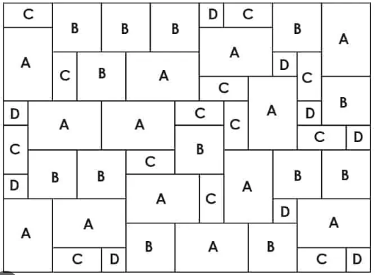

Has your buddy tried searching the web? The paving companies either have a good programme, or someone who has spent years figuring it out!
Here is a picture I took off the web - I wonder what programme drew it!
Picture attached is very interesting... The trick in solving big rectangle is that every piece is Euclidian : dxd - smallest rectangle/square : D=1D - square , C=2D , B=4D, A=6D...

Thanks for all the tips guys.   What I wound up doing is taking a pattern from the manufacturer which is an "L" shape.    Made that a block.  Then just manually copied  that into place.  Now when I get the dimensions of the driveway I will just lay that over and line it up.
Its a mind bender just to dream up the logic in order to make a script!
