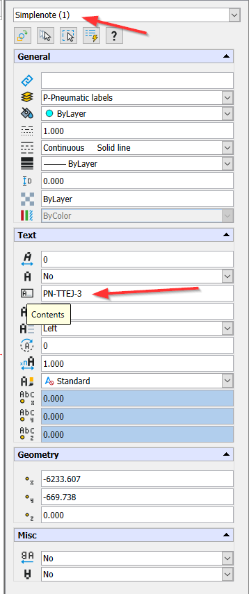

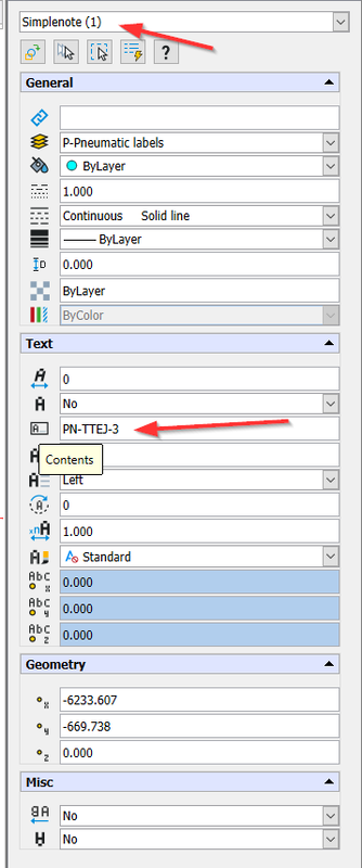

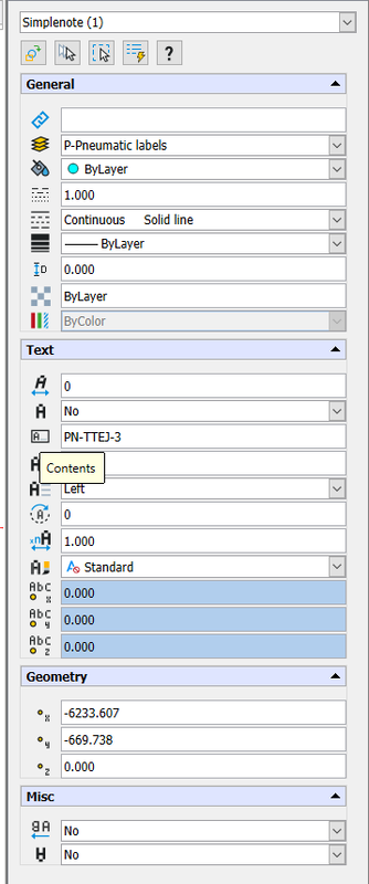

Sajim Posted June 11, 2023 Author Share Posted June 11, 2023 Thanks much for the responses. Draftsight Premium does sup1235 Pneumatic Circuits-Labels.dwgport LISP. I think it is very similar to AutoCAD just different names for entities I suppose. I've attached the drawing which consists of a number of text entities (simplenotes). @Steven P I tried the entget suggestion and just got a Note inserted as below: This is a 'Note' which is a Mtext equivalent - multiline text. The notes I'm aiming for are SimpleNotes. A screen shot of the properties below and the contents field I'm trying to extract. I asked friend ChatGPT to make a lisp and it came up with this: simplenotes-to-csv.lsp (defun c:simplenotes-to-csv () (setq selection (ssget)) (if selection (progn (setq output-file (getfiled "Save CSV File" "" "csv" 1)) (setq output-string "Contents\n") (setq note-count 0) (repeat (sslength selection) (setq entity (ssname selection 0)) (setq selection (ssdel entity selection)) (if (eq (cdr (assoc 0 (entget entity))) "SIMPLENOTE") (progn (setq note-count (+ note-count 1)) (setq contents (cdr (assoc 1 (entget entity)))) (setq output-string (strcat output-string contents "\n")) ) ) ) (setq output-string (strcat output-string "\nTotal Notes: " (itoa note-count))) (setq output-file (open output-file "w")) (write-line output-string output-file) (close output-file) (princ "CSV file created successfully.") ) (princ "No Simplenotes found in the selection.") ) (princ) ) Quite impressive that it could prompt for selecting entites etc. But the CSV was empty unfortunately. ChatGPT (0) - Humans (TBC) Quote Link to comment Share on other sites More sharing options...
