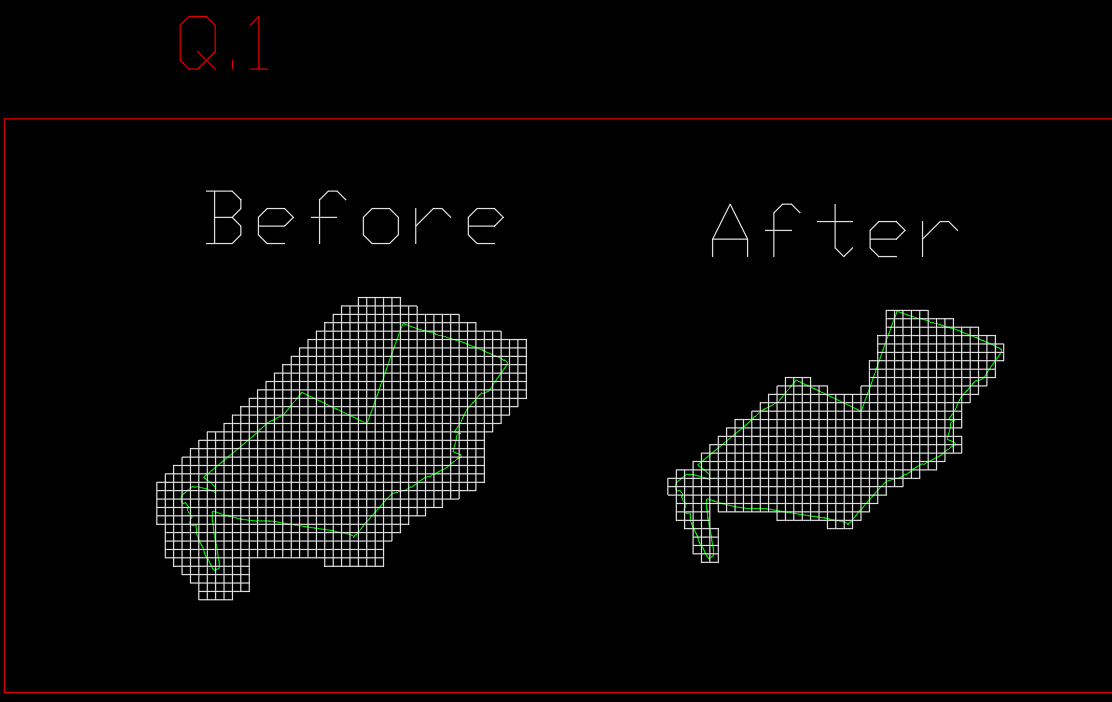

I'm looking for a LISP routine that can do conditional trimming.
Currently, I have an irregularly closed polyline in my drawing, referred to as BpolyA, along with horizontal and vertical line segments spaced 80m apart, referred to as Grid80.
I want to be able to delete things outside of Grid80 based on BpolyA, with the desired result shown in the 'after' image. Is there any way to do this?

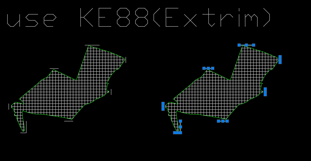

I have a LISP routine that can create a region based on BpolyA and Grid80.
But there's a problem with the first step, 'Extrim'. Is there a way to also delete objects outside of BpolyA?
Here is the example DWG

(defun C:KE88 ()
(alert "Please be sure to copy it to the side first before proceeding with the operation.")
(C:EXTRIM)

Q1.  probably not what you want but create small squares 80x80 & create a grid over the polyline. then use the following lisp.
;;DELETE ALL outside Polyline
(defun C:PCross (/ SS1 SS2 coords)
  (setq SS1 (ssget)) ;Select everything
  (if (setq SS (ssget "_+.:E:S" '((0 . "*POLYLINE")))) ;select polyline
      (setq coords (vl-remove-if 'not (mapcar (function (lambda (p) (if (= 10 (car p)) (cdr p)))) (entget (ssname SS 0)))))
      (setq SS2 (ssget "_CP" coords))
      (foreach ent (vl-remove-if 'listp (mapcar 'cadr (ssnamex SS2)))
        (ssdel ent SS1)
  (foreach ent (vl-remove-if 'listp (mapcar 'cadr (ssnamex SS1)))
    (entdel ent)

Thank you for ur method, but my GRID must be created using LINE, not Block.
because for slope analysis use.....🤔
Try Cookie Cutter.lsp sometimes much better than extrim.
Edited by BIGAL
Thank you for the reminder, that's exactly the function I need!
