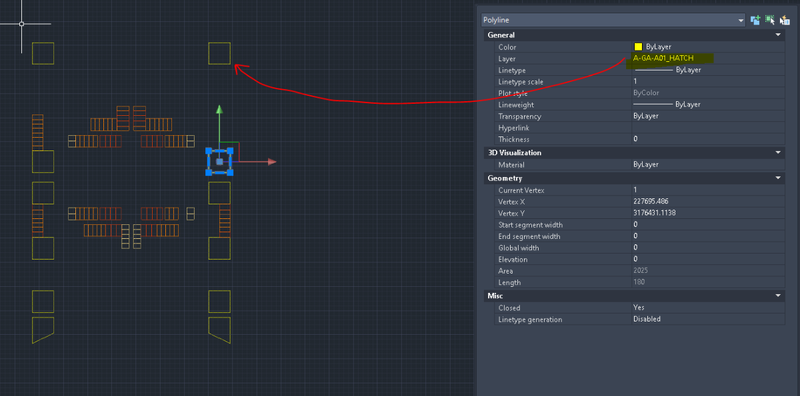

I need to create create regions out of polylines and allocate these new regions into the layer of the polylines it was created from. The region command does the first step but it allocates all the new region in the same layers so I am trying to make the process quicker not do go one-by-one.
