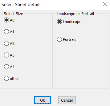

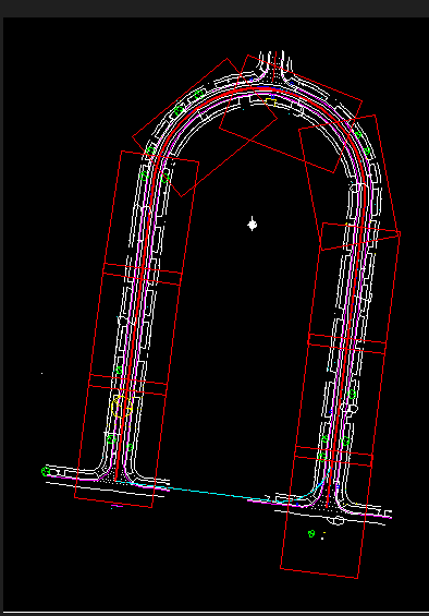

Not an answer but a way more enhanced way to do what your asking. Its part of a make layouts it asks also for scale then makes rectangs of the correct size in plan, then when happy can move delete or rotate the rectangs, you make layouts, did a test other day and made 108. Happy to discuss not free but cheap.
The free answer make a dwg with multiple layouts, each containing 1 title block per layout, then use Layout Copy T pick dwg and select correct size.
