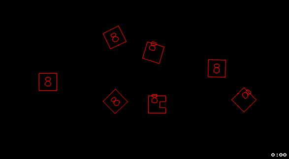

sm177y Posted May 20, 2023 Share Posted May 20, 2023 I have this function that copies the rotation angle of one block to another but it does not rotate the text attributes with the block like happens if I were to manually copy and paste the rotation angle from the one blocks properties menu to the other blocks. The attributes stay stuck at their previous rotation and position. How do I make this also affect the attributes so that it effectively does exactly the same thing as copying the rotation angle in the properties menu? For a better description, I have a block that is a square with a text number in the middle of it. When I use this function it only rotates the square which brings the square away from the text and the text no longer resides within the square. If I copy the rotation in the properties menu of each block the text rotates with the square and stays inside of it. ;; copies rotation of one block to another (defun c:cr (/ blk1 blk2 rot1) (setq blk1 (car (entsel "\nSelect block to copy rotation from: "))) (if (not (setq rot1 (cdr (assoc 50 (entget blk1))))) (progn (princ "\nBlock has no rotation angle.") (exit) ) ) (setq blk2 (car (entsel "\nSelect block to apply rotation to: "))) (entmod (subst (cons 50 rot1) (assoc 50 (entget blk2)) (entget blk2))) (princ) ) Quote Link to comment Share on other sites More sharing options...

sm177y Posted May 22, 2023 Author Share Posted May 22, 2023 So it does rotate the text but it does not maintain its position within the block. The center text in the square has been copied to the rotate of the first block, 0 in my test, but the text is half outside the square instead of in the center. If I do this manually in the properties menu it is not an issue. I was able to get my hands on this which essentially does what i want but requires defining an angle. is it possible to extract the angle from the first block and apply it to the other block via this method somehow? (defun dtr (a) (* pi (/ a 180.0))) (defun rtd (a) (/ (* a 180.0) pi)) ;;;;;;;;;;;;;;;;;;;;;;;;;;;;;;;;;;;;;;;;;;;;;;;;;;;;;;;;; ;;;;; Prompts you to select 2 point to set an angle ;;;;; ;;;;;; then select block(s) you want to rotate ;;;;;; ;;;;;;;;;;;;;;;;;;;;;;;;;;;;;;;;;;;;;;;;;;;;;;;;;;;;;;;;; (defun c:as () (setq cecho (getvar "cmdecho")) (setvar "cmdecho" 0) ; (setq blknam (getstring "\nEnter block name to set angles to: ")) ;(setq blksel (ENTSEL "\nPick Block to rotate...")) ;(setq blkent (car blksel)) ;(SETQ blknam (cdr (assoc 2 (entget blkent)))) (prompt "\nPick two points to set angle: ") (setvar "osmode" 545) (setq setang (getangle)) (setq setang (rtd setang)) (setvar "osmode" 0) (setq selset (ssget (list (cons 2 "*")))) (if (= selset nil) (progn (prompt "\nNo block found...GOODBYE!\n") (exit) (princ) ) ;_end of progn ) ;_end if (setq setlen (sslength selset)) (repeat setlen (setq blkent (ssname selset (setq setlen (- setlen 1))) blkpnt (cdr (assoc 10 (entget blkent))) blkang (cdr (assoc 50 (entget blkent))) ) (setq newang (+ (- 360 (rtd blkang)) setang)) (command "rotate" blkent "" blkpnt newang) );_end repeat ) Quote Link to comment Share on other sites More sharing options...

sm177y Posted May 23, 2023 Author Share Posted May 23, 2023 It's already middle center. Here's a sample dwg. The first block is the one at zero rotation i'm trying to copy. The 2nd is before the rotation copy and the 3rd is the same as the 2nd but after applying the function to it. Thanks for your time on this test.dwg Quote Link to comment Share on other sites More sharing options...

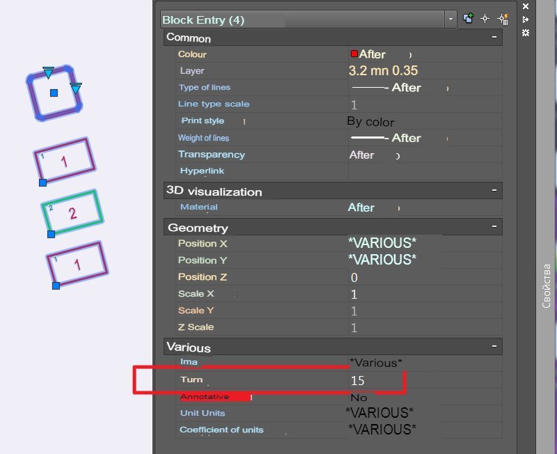

Nikon Posted May 24, 2023 Share Posted May 24, 2023 If you select all blocks (even with different names and different angles of turns), then you can set the required angle for all blocks in the properties. And the attributes remain in their places after the turn... Quote Link to comment Share on other sites More sharing options...

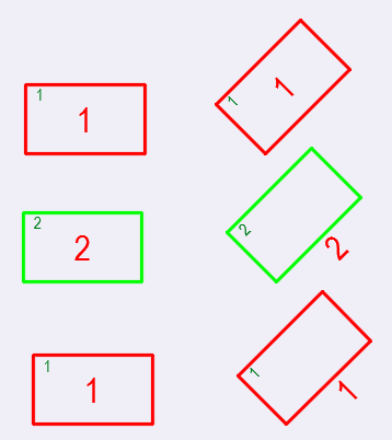

Tharwat Posted May 24, 2023 Share Posted May 24, 2023 Give this a shot and let me know, although what you want in this case just to run the ATTSYNC command on the selected attributed blocks. (defun c:Test (/ pck int ent sel rot get lst bkn ) ;;----------------------------------------------------;; ;; Author : Tharwat Al Choufi ;; ;; website: https://autolispprograms.wordpress.com ;; ;;----------------------------------------------------;; (and (princ "\nSelect single block to get rotation from : ") (or (setq pck (ssget "_+.:S:E" '((0 . "INSERT")))) (alert "Null or invalid object.! Try again") ) (princ "\nSelect blocks to apply rotation on : ") (setq rot (assoc 50 (entget (ssname pck 0))) int -1 sel (ssget "_:L" '((0 . "INSERT"))) ) (while (setq int (1+ int) ent (ssname sel int) ) (and (setq get (entget ent)) (entmod (subst rot (assoc 50 get) get)) (= (cdr (assoc 66 get)) 1) (or (member (setq bkn (cdr (assoc 2 get))) lst) (setq lst (cons bkn lst)) ) (mapcar '(lambda (u) (vla-put-rotation u (cdr rot))) (vlax-invoke (vlax-ename->vla-object ent) 'getattributes) ) ) ) ) (and lst (mapcar '(lambda (u) (vl-cmdf "_.ATTSYNC" "_N" u)) lst)) (princ) ) (vl-load-com) Quote Link to comment Share on other sites More sharing options...

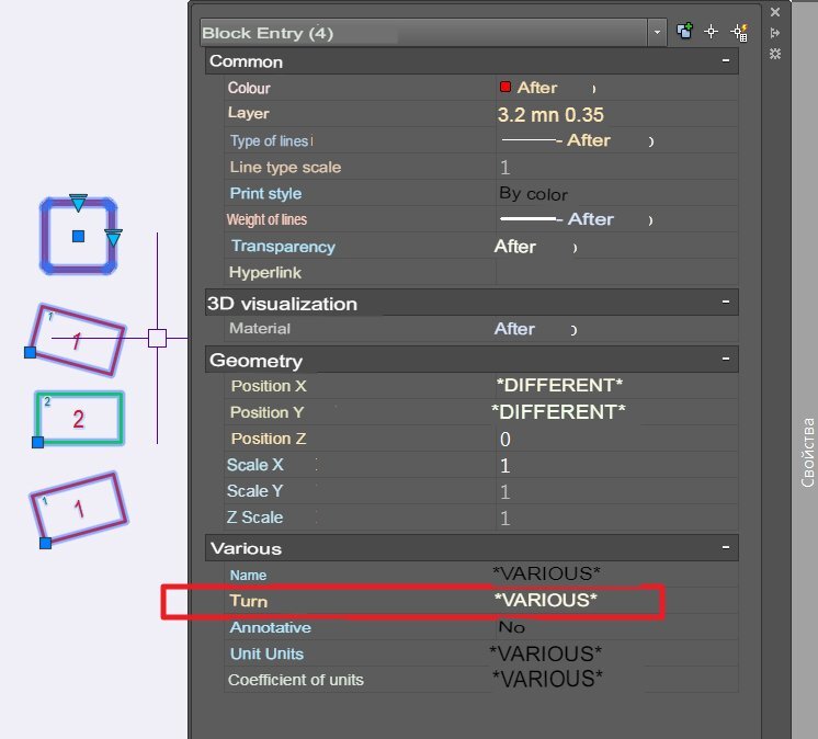

Nikon Posted May 24, 2023 Share Posted May 24, 2023 But it doesn't work, attributes move out... In the figure, the first block is rotated through properties, the rest using lisp. AutoCAD 2015. Quote Link to comment Share on other sites More sharing options...
Tharwat Posted May 24, 2023 Share Posted May 24, 2023 I don't know about your block status, but on OP's block, so here is a demo using two rotations Quote Link to comment Share on other sites More sharing options...
Nikon Posted May 24, 2023 Share Posted May 24, 2023 No, I'm sorry, now the block is rotated and the attributes are not shifted... Quote Link to comment Share on other sites More sharing options...
Tharwat Posted May 24, 2023 Share Posted May 24, 2023 The alignment of attribute object should in Middle Center which would guarantee perfect rotation in blocks. Quote Link to comment Share on other sites More sharing options...
