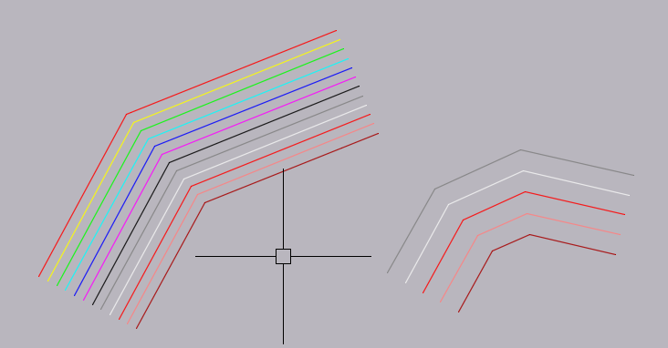

Hello friends!
I want to write 1 lisp draw 1 time into 12 plines with different colors as the picture attached, but the lisp writing skill is not good, please help me to edit it. Thank you

Hi,
If you want use the DXF code 62, you are limited to (0 at 256) 0=ByBlock 256=ByLayer
Else you must use DXF code 420 with RGB colors (it's a long interger) and is more complicated.
Exemple whith:
(setq colorMap '(11 41 71 101 131 161 191 221 32 62 92 122))
Your code work's well!

Lisp draws 2-12 polylines of different colors with a choice of the distance between them.
I don't know the author...
Calling with the mln command

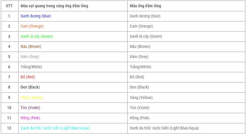

Try with this list in your code:
(setq colorMap '(170 30 90 26 252 7 10 250 50 190 210 130))
But this selection is very personal (tastes and colors...)
Test this list in command line, to see if it is good for you.
(mapcar '(lambda (x) (acad_colordlg x nil)) '(170 30 90 26 252 7 10 250 50 190 210 130))

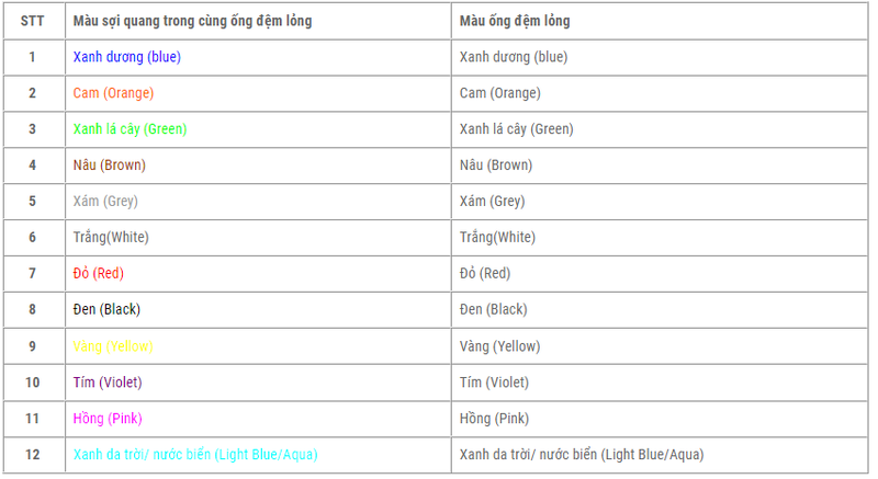

@Nikon Thanks for your help
The first 6 colors are in the correct order but the order is reversed between 7 and 12, 8 with 11, 9 and 10. Please help me to fix it.

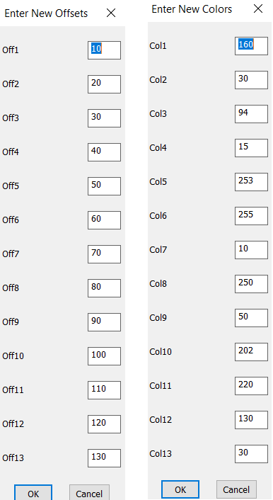

My attempt, you can enter up to 13 offsets actaully around 20 is possible. Enter 0 or just erase for last entry check. Supports -ve as well.
; (defun c:mln ( / _OffsetTo items ofd InsertAt evenp layersAndColors plines base colorMap)
  (vl-load-com)
 (defun c:mln ( /  )
(setq colorMap '(160 30 94 15 253 255 10 250 50 202 220 130))
(if (not AH:getvalsm)(load "Multi Getvals.lsp"))
(setq ans (AH:getvalsm (list "Enter New Offsets "
 "Off1 " 5 4 "10"
 "Off2 " 5 4 "20"
 "Off3 " 5 4 "30"
 "Off4 " 5 4 "40"
 "Off5 " 5 4 "50"
 "Off6 " 5 4 "60"
 "Off7 " 5 4 "70"
 "Off8 " 5 4 "80"
 "Off9 " 5 4 "90"
 "Off10 " 5 4 "100"
 "Off11 " 5 4 "110"
 "Off12 " 5 4 "120"
 "Off13 " 5 4 "130")

(initget "Yes No")
(setq YN (getkword "\nDo you want to number the lines? [Yes/No] <Yes>: "))
(if (= YN "Yes")
    (setq numberPos (getpoint "\nSelect position for the numbers: "))
    (setq ptx (- (car numberpos)(car start)))
    (setq pty (- (cadr numberpos)(cadr start)))
(setvar 'textstyle "Standard")
(setq x 0)
(repeat ln
  (vla-offset obj (atof (nth x ans)))
  (setq obj2 (vlax-ename->vla-object (entlast)))
  (vla-put-layer obj2 (car (nth x layersAndColors)))
  (setq start (vlax-curve-getstartpoint obj2))
  (if (= yn "Yes")
    (setq numberpos (mapcar '+ start (list ptx pty 0.0)))
    (command "text" numberPos 2.5 0.0 (strcat "Line: " (itoa x)))
  (setq x (1+ x))
(c:mln)
You need to save the multi getvals.lsp to your support path directory for autoload.
Multi GETVALS.lsp
Thanks for Reply
APPLOAD Multi GETVALS.lsp successfully loaded.
Command: (10 20 30 40 50 60 70 80 90 100 110 120 130); error: bad argument type: fixnump: nil
So you want to pass a different color combo than the hard coded (setq colorMap '(160 30 94 15 253 255 10 250 50 202 220 130)).
I am working on  a multi getvals 2 col version so colors one side the other would be offsets, is that what you want ?
Edited by BIGAL
