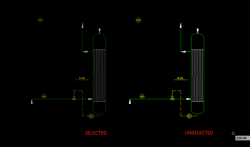

I'd like to write a lisp routine to select attributes blocks, first  I need to window select those using 2 points, then for those doesn't in this erea, i need to pick the blocks one by one, in order to tell which is selected or unselected , i need those selected display different from those unselected.

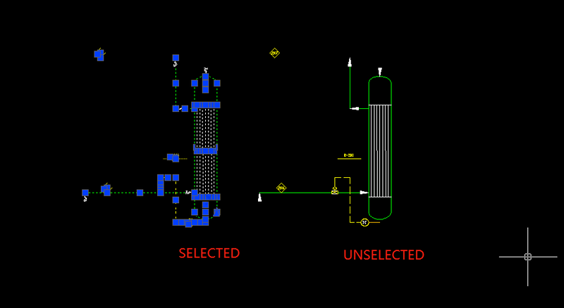

picture 2 underbelow is prefered.
Like devitg pick pick pick or window select then hold shift and pick pick deselects. The other way is with filters but need say name of blocks to select.
On 5/16/2023 at 6:54 PM, devitg said:
@CANDOWE
;just for one
(SETQ ENT (CAR (ENTSEL "pick ent")))
(REDRAW ENT 3)
; for a few
(SETQ SS-ENT (SSGET))
THIS IS  A FANTASTIC AND EASY IDEA
