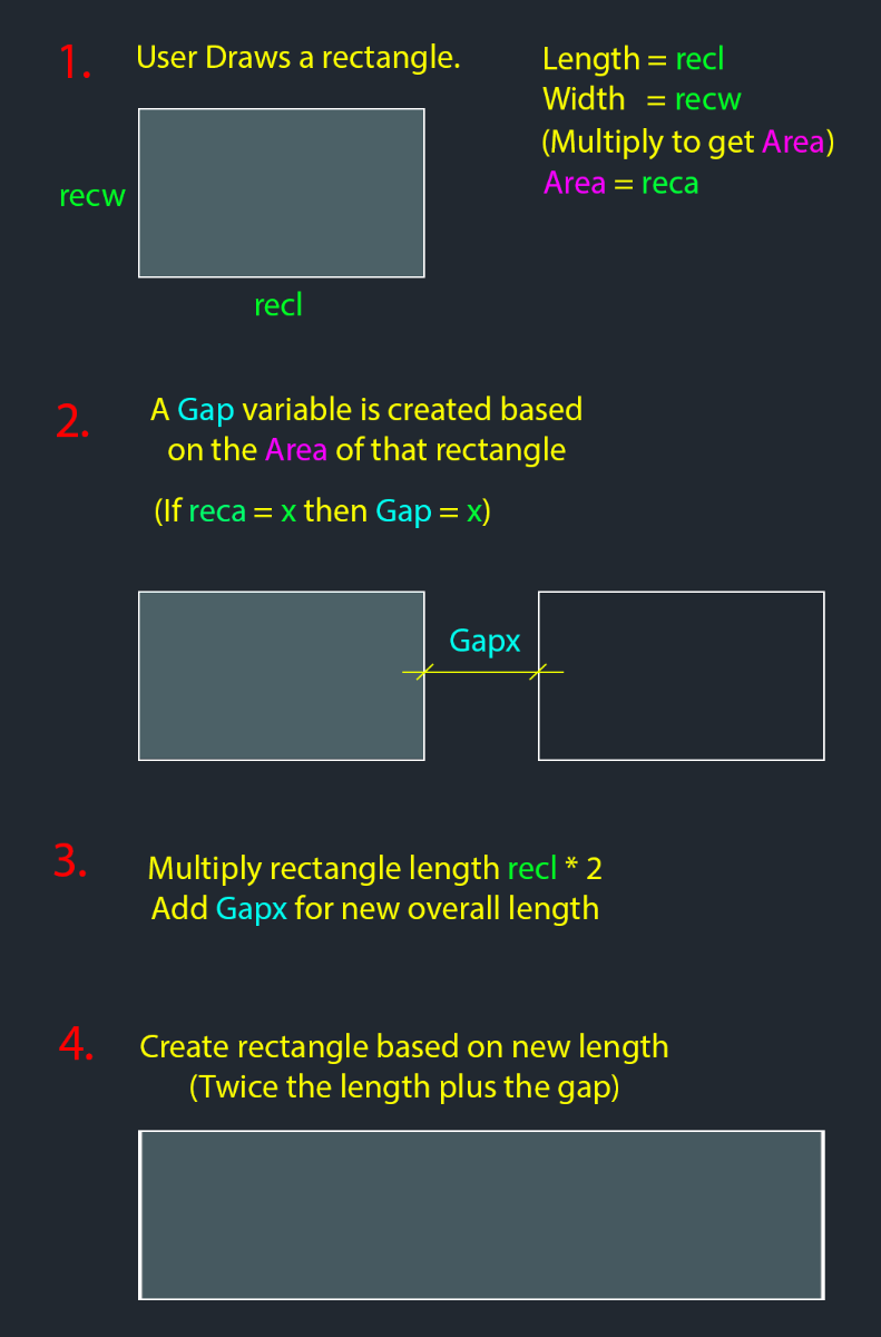

Hello all
I think I’m not getting the third point (pt3gap) in my rectangle correctly when I try to draw a new one.
Goal:
-create a rectangle.
-Get the Area (reca) of that rectangle created. Length (recl) x Width (recw).
-Create a variable called Gap. Value is based on the Area found.
-Multiply the length of the rectangle by 2. Then add the Gap distance.
-Create another rectangle based on new length (recl * 2 + Gap)
-Delete old rectangle
Illustration:
My Code:

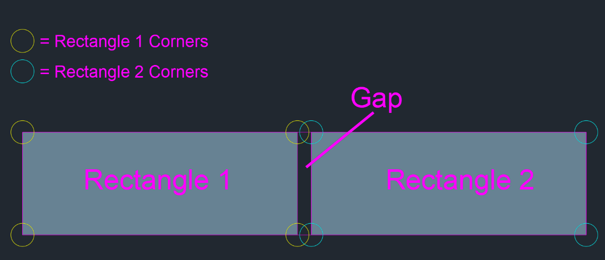

I’m trying to do something different with the working routine above.
-Create a small rectangle
- Copy to make a second small rectangle and place next to first (plus the gap size).
- Have both smaller rectangles showing (plus the overall larger rectangle)
 -Save all four corners of both rectangles to variables to use later.
First rectangle corner points saved:
firstboxpt1
firstboxpt2
firstboxpt3
firstboxpt4
Second rectangle corner points saved:
Secondboxpt1
Secondboxpt2
Secondboxpt3
Secondboxpt4
I have colored circles placed at all corner points of both rectangles to show that its working but they don’t show up.
Trying to look like this:
Im getting an error.
Can anyone see what Im doing wrong?

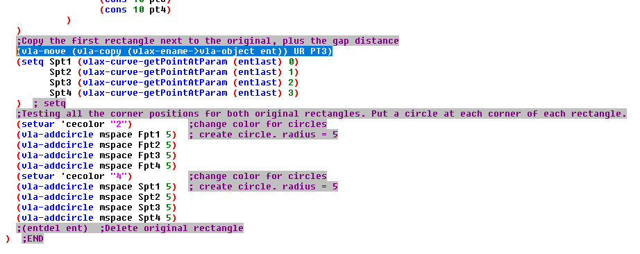

Thanks for all the help Mhupp!
Your error is with calculating Second box points. you need to use polar to calculate the correct point.
But since drawing the circle's can be done in any order just use what you had in the first lisp to calculate their points.
;;    -Create rectangle.                                           ;;
;;    -Get GAP size based on Area of rectangle                     ;;
;;    -Create longer rectangle (x2) plus GAP                       ;;
;;    -Copy original rectangle over (plus the GAP size)            ;;
;;    -Save all corners of both orignal rectangles to variables    ;;
(defun c:zzz (/ drawing mspace ent ptslst LL UR L&W len wid area pt1 pt2 pt3 pt4 gap Fpt1 Fpt2 Fpt3 Fpt4 Spt1 Spt2 Spt3 Spt4)
  (vl-load-com)
  (setq drawing (vla-get-activedocument (vlax-get-acad-object))) ;needed for vlax-addcircle
  (setq mspace (vla-get-modelspace drawing)) ;needed for vlax-addcircle
  (setvar 'cecolor "6")  ;use setvar rather then command its faster and doesn't have and output to the command line.
  (command "_.rectang"
           (while (< 0 (getvar 'CMDACTIVE)) (command pause))  ;waits for user to complete command

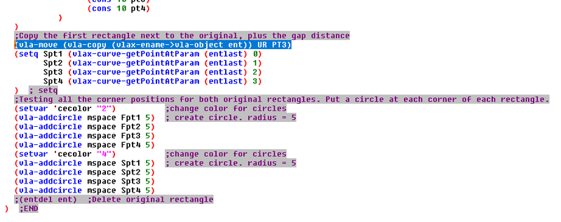

I ran the code and can't seem to get it to work for me. I'm getting the following error at the command prompt.
Command: ZZZ
_.rectang
Specify first corner point or [Chamfer/Elevation/Fillet/Thickness/Width]:
Specify other corner point or [Area/Dimensions/Rotation]:
Command:
Command: ; error: lisp value has no coercion to VARIANT with this type:  (2854.41 1021.74 0.0)
Command: Regenerating model
I put an Break on Error under Debug and ran last error and it  stopped at the following line.
(vla-move (vla-copy (vlax-ename->vla-object ent)) UR PT3)
I started commenting out sections of code to try and isolate where the issue was but only got more errors.😕
Did the routine work for you by chance?
Thanks again for you help!
Yes but I use BricsCAD so somethings are different. easiest fix would be to swap that line back out for this.
(Command "copy" ent "" ur pt3)
