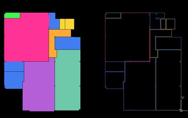

3dwannab Posted May 11, 2023 Posted May 11, 2023 Hi all, there's no point in reinventing the wheel. I was looking to see if there's a program to hatch each of the closed polylines to match each layer and colour. I'm doing a schedule for each room so this would be fairly handy. Thanks in advance. Solid Hatch Each Boundary With Properties of Boundary.dwg Quote
fuccaro Posted May 11, 2023 Posted May 11, 2023 (defun c:MyHatch() (setq ss (ssget "X" (list '(0 . "LWPOLYLINE") '(70 . 1)))) (repeat (setq i (sslength ss)) (setq p (ssname ss (setq i (1- i)))) (setq pl (entget p) lay (assoc 8 pl) color (assoc 62 pl) ) (command "_hatch" "s" p "") (setq hatch (entget (entlast)) hatch (subst lay (assoc 8 hatch) hatch) ) (cond (color (setq hatch (append hatch (list color)))) ) (entmod hatch) ) (setq ss nil) ) Just a quick one... 2 1 Quote
3dwannab Posted May 11, 2023 Author Posted May 11, 2023 (edited) Thanks very much @fuccaro. I added undo handling and used the ":L" ssget to get preselection or selection. Here's that if anyone wants it. (vl-load-com) ;; See thread here: https://www.cadtutor.net/forum/topic/77467-hatch-to-each-of-the-closed-polylines-match-the-colour-layer/ ;; Program to hatch closed polylines to match the layer and colour of each selection polyline. ;; Answer by fuccaro and added undo handling and changed the selection method by myself (3dwannab) ;; First written on 2023.05.11 (defun c:HBC nil (c:HH_Boundary_Colour)) (defun c:HH_Boundary_Colour (/ *error* acDoc hatch i p pl ss1 var_cmdecho var_osmode) (defun *error* (errmsg) (and acDoc (vla-EndUndoMark acDoc)) (and errmsg (not (wcmatch (strcase errmsg) "*CANCEL*,*EXIT*")) (princ (strcat "\n<< Error: " errmsg " >>\n")) ) (setvar 'cmdecho var_cmdecho) (setvar 'osmode var_osmode) ) (setq acDoc (vla-get-ActiveDocument (vlax-get-acad-object))) (or (vla-EndUndoMark acDoc) (vla-StartUndoMark acDoc)) (setq var_cmdecho (getvar "cmdecho")) (setq var_osmode (getvar "osmode")) (setvar 'cmdecho 0) (setvar 'osmode 0) (setq ss1 (ssget ":L" (list '(0 . "LWPOLYLINE") '(70 . 1)))) (repeat (setq i (sslength ss1)) (setq p (ssname ss1 (setq i (1- i)))) (setq pl (entget p) lay (assoc 8 pl) color (assoc 62 pl) ) (command "_hatch" "s" p "") (setq hatch (entget (entlast)) hatch (subst lay (assoc 8 hatch) hatch) ) (cond (color (setq hatch (append hatch (list color)))) ) (entmod hatch) ) (*error* nil) (princ) ) (princ (strcat " \n: ------------------------------\n'Hatch_Boundary_Colour.lsp' Loaded | Invoke by typing 'HH_Boundary_Colour' or 'HBC'.\n: ------------------------------\n")) (princ) Edited May 11, 2023 by 3dwannab Quote

3dwannab Posted May 16, 2023 Author Posted May 16, 2023 (edited) Just need to fix the hatch as it was non-associative. Here's that fix ; (command "_hatch" "s" p "") ;; Original hatch command. Created a non-associative hatch (command "-hatch" "P" "SOLID" "A" "A" "Y" "" "T" "." "S" p "" "") ;; Working for solid hatch with asssocitivity @mdchuyen, to hatch with pattern name: (command "-hatch" "P" "Ansi31" "555" "0" "A" "A" "Y" "" "T" "." "S" p "" "") ;; Hatch with pattern name where scale is 555. Edited May 16, 2023 by 3dwannab 1 Quote

3dwannab Posted May 17, 2023 Author Posted May 17, 2023 (edited) I wonder what the easiest way to get the hatch to go to a true colour is if the polyline is. This is my brute-force method. (command "_.matchprop" "_non" p "_non" (entlast) "") Is there a variable or registry value for match prop settings. It was asked before on theswamp but that thread is 12 year old. https://www.theswamp.org/index.php?topic=37406.0 I'm sure there was one and I had it in one of my programs but can't find it anywhere. Edited May 17, 2023 by 3dwannab Quote
Steven P Posted May 17, 2023 Posted May 17, 2023 (command "chprop" (ssget "_:L-I") "" "COLOR" "t" "255,51,204" "") (Crayola Razzle Dazzle Rose colour....) and I don't care,. this is the lisp name, like it or not,. (defun c:Lauper ( / ) ; True colours. (setq MyEnt (car (entsel))) (setq MyObj (vlax-ename->vla-object MyEnt)) ;;https://adndevblog.typepad.com/autocad/2012/12/accessing-the-truecolor-property-using-visual-lisp.html (setq oColor (vlax-get-property MyObj 'TrueColor) clrR (vlax-get-property oColor 'Red) clrG (vlax-get-property oColor 'Green) clrB (vlax-get-property oColor 'Blue) ) ;;Match colour (princ "Thanks, select objects to change") (command "chprop" (ssget "_:L-I") "" "COLOR" "t" (strcat (rtos clrR) "," (rtos clrG) "," (rtos clrB)) "") ) 2 Quote
ronjonp Posted May 18, 2023 Posted May 18, 2023 (edited) On 5/17/2023 at 9:25 AM, 3dwannab said: I wonder what the easiest way to get the hatch to go to a true colour is if the polyline is. This is my brute-force method. (command "_.matchprop" "_non" p "_non" (entlast) "") Is there a variable or registry value for match prop settings. It was asked before on theswamp but that thread is 12 year old. https://www.theswamp.org/index.php?topic=37406.0 I'm sure there was one and I had it in one of my programs but can't find it anywhere. Give this a try. It will match INDEX, RGB and COLORBOOK as well as match the LAYER NAME. It has the added benefit of also leaving bylayer colors intact. (defun c:foo (/ f h o s sp) ;; RJP » 2023-05-18 (cond ((setq s (ssget '((0 . "CIRCLE,ELLIPSE,*POLYLINE,SPLINE")))) (setq sp (vlax-ename->vla-object (cdr (assoc 330 (reverse (entget (ssname s 0))))))) (foreach e (vl-remove-if 'listp (mapcar 'cadr (ssnamex s))) (cond ((vlax-curve-isclosed e) (setq h (vlax-invoke sp 'addhatch achatchobject "SOLID" :vlax-true)) (vlax-invoke h 'appendouterloop (list (vlax-ename->vla-object e))) (setq f (vl-remove-if-not '(lambda (x) (member (car x) '(8 62 420 430))) (entget e))) ;; Match layer and byobject colors (entmod (append (entget (vlax-vla-object->ename h)) f)) (vla-evaluate h) ) ) ) ) ) (princ) ) Edited May 18, 2023 by ronjonp 1 Quote

3dwannab Posted October 23, 2024 Author Posted October 23, 2024 (edited) Added the ability to select a hatch after creation of hatches to match the new ones. (vl-load-com) ;; ;; See thread here: https://www.cadtutor.net/forum/topic/77467-hatch-to-each-of-the-closed-polylines-match-the-colour-layer/ ;; ;; Program to hatch objects in the ssget filter below to match the layer, colour and transparency of each object. ;; Answer by fuccaro and added undo handling and changed the selection method by myself (3dwannab) ;; ;; NOTE: The _createOrUpdateLayer function is located in the acaddoc.lsp file. ;; ;; First written on 2023.05.11 ;; Last modified on 2024.06.04 by 3dwannab ;; Last modified on 2024.06.04 by 3dwannab - Added the ability to select a hatch after creation of hatches to match the new ones. ;; (defun c:HBC nil (c:HH_Boundary_Colour)) (defun c:HH_Boundary_Colour (/ *error* acDoc bdata entH f hObj layerName sp ssPolyClosed ssSelHatch var_cmdecho var_osmode) (defun *error* (errmsg) (and acDoc (vla-EndUndoMark acDoc)) (and errmsg (not (wcmatch (strcase errmsg) "*CANCEL*,*EXIT*")) (princ (strcat "\n<< Error: " errmsg " >>\n")) ) (setvar 'cmdecho var_cmdecho) (setvar 'osmode var_osmode) ) (setq acDoc (vla-get-ActiveDocument (vlax-get-acad-object))) (or (vla-EndUndoMark acDoc) (vla-StartUndoMark acDoc)) (setq var_cmdecho (getvar "cmdecho")) (setq var_osmode (getvar "osmode")) (setvar 'cmdecho 0) (setvar 'osmode 0) (setq ssSelHatch (ssadd)) ;; RJP » 2023-05-18 (cond ((setq ssPolyClosed (ssget "_:L" '((0 . "CIRCLE,ELLIPSE,*POLYLINE,SPLINE")))) (setq sp (vlax-ename->vla-object (cdr (assoc 330 (reverse (entget (ssname ssPolyClosed 0))))))) (foreach e (vl-remove-if 'listp (mapcar 'cadr (ssnamex ssPolyClosed))) (cond ((vlax-curve-isclosed e) (setq hObj (vlax-invoke sp 'addhatch achatchobject "SOLID" :vlax-true)) (vlax-invoke hObj 'appendouterloop (list (vlax-ename->vla-object e))) (setq f (vl-remove-if-not '(lambda (x) (member (car x) '(8 62 420 430 440))) (entget e))) ;; Match layer and byobject colors (entmod (append (entget (vlax-vla-object->ename hObj)) f)) (vla-evaluate hObj) ;; Put transparency to the new hatch if it matches a certain layer name. This is is for the "AN_revision" layer. ;; Added by 3dwannab on 2024.05.09 (if (or (and hObj (wcmatch (cdr (assoc 8 (entget e))) "*rev*")) (and hObj (wcmatch (cdr (assoc 8 (entget e))) "*boundary*")) ) (vla-put-EntityTransparency hObj "85") ) ;; Put layer to "CH_existing" to the new hatch if it matches a wildcard layer with *existing* in it. ;; Added by 3dwannab on 2024.06.21 (if (and hObj (wcmatch (cdr (assoc 8 (entget e))) "*existing*")) (progn (setq layerName "CH_existing") ;; Create a layer, this defun is in the acaddoc.lsp file (_createOrUpdateLayer layerName '(130 130 130) "Continuous" acLnWtByLwDefault 50 :vlax-true "Craftstudio Layer - Colour Hatch Layer") ;; Set the objects to the correct properties for the 'GN_wipe-out' layer. (vl-catch-all-error-p (vl-catch-all-apply 'vla-put-Layer (list hObj layerName))) (vl-catch-all-error-p (vl-catch-all-apply 'vla-put-Linetype (list hObj "ByLayer"))) (vla-put-LineWeight hObj aclnwtbylayer) (vla-put-Color hObj acbylayer) (vla-put-LinetypeScale hObj 1) (vla-put-EntityTransparency hObj "ByLayer") ) ;; progn ) ; if ;; Put layer to "GN_wipe-out" to the new hatch if it matches a certain layer name ;; Added by 3dwannab on 2024.05.21 (if (and hObj (wcmatch (cdr (assoc 8 (entget e))) "0")) (progn (setq layerName "GN_wipe-out") ;; Create a layer, this defun is in the acaddoc.lsp file (_createOrUpdateLayer layerName '(254 254 254) "Continuous" 025 0 :vlax-true "Craftstudio Layer - General Layer: Useful for furniture and other movable objects to obscure whats behind") ;; Set the objects to the correct properties for the 'GN_wipe-out' layer. (vl-catch-all-error-p (vl-catch-all-apply 'vla-put-Layer (list hObj layerName))) (vl-catch-all-error-p (vl-catch-all-apply 'vla-put-Linetype (list hObj "ByLayer"))) (vla-put-LineWeight hObj aclnwtbylayer) (vla-put-Color hObj acbylayer) (vla-put-LinetypeScale hObj 1) (vla-put-EntityTransparency hObj "ByBlock") ) ;; progn ) ; if (setq ssSelHatch (ssadd (entlast) ssSelHatch)) ) ;; end cond ) ) ) ) ;; Pick a hatch to match the properties to the newly created hatches ;; This will wait until the user selects a hatch (while (not (and (setq entH (car (entsel "\nSelect the hatch to match properties from: "))) (setq bdata (if entH (entget entH))) (= (cdr (assoc 0 bdata)) "HATCH") ) ) (prompt "\nNothing selected, or it is not a HATCH -- ") ) ;; If the hatch is selected do this (if entH (command "_.matchprop" "_non" entH "_non" ssSelHatch "") ) ;; If ssSelHatch, select the newly created hatches (if ssSelHatch (progn (princ (strcat "\n: ------------------------------\n\t\t<<< " (itoa (sslength ssSelHatch)) (if (> (sslength ssSelHatch) 1) " <<< HATCHES" " <<< HATCH") " created\n: ------------------------------\n")) (command "_.draworder" ssSelHatch "" "_B") (sssetfirst nil ssSelHatch) (command "_.regen") ) ) (vla-EndUndoMark acDoc) (*error* nil) (princ) ) ; (c:HBC) ;; UNblock for testing (princ (strcat " \n: ------------------------------\n'Hatch_Boundary_Colour.lsp' Loaded | Invoke by typing 'HH_Boundary_Colour' or 'HBC'.\n: ------------------------------\n")) ;;;;;;;;;;;;;;;;;;;;;;;;;;;;;;;;;;;;;;;;;;;;;;;;;;;;;;;;;;;; ;; ;; _createOrUpdateLayer ;; ;; Creates a new layer or updates an existing one if it exists. ;; Will attempt to load the linetype if found in the acad*.lin file and if the layer exists, it will update the properties. ;; Original code by ronjonp, taken from: https://forums.autodesk.com/t5/visual-lisp-autolisp-and-general/create-layer-with-true-color-in-lisp/m-p/7904814#M367339 ;; ;; USAGE: ;; (_createOrUpdateLayer "Test1" 22 "Dashed" aclnwtbylwdefault 33 :vlax-true "Test1 Description") ;; (_createOrUpdateLayer "Test2" '(100 150 200) "Continuous" aclnwtbylwdefault 33 :vlax-false "Test2 Description") ;; ;; The :vlax-true or :vlax-false in examples above is for plot on or off. ;; The 33 values represent the transparency of the layer. ;; Original help from mhupp here to get it to update layer if it exists: https://www.cadtutor.net/forum/topic/75414-defun-to-create-or-update-layers-not-updating-them/?do=findComment&comment=596266 ;; ;; ARGUMENTS: ARGUMENTS SYTAX: ;; 1st arg: Layers Name = STRING ;; 2nd arg: Layers Colour = 22 or '(100 150 200) (Can be an indexed colour or true colour) ;; 3rd arg: Layers Linetype = STRING ;; 4th arg: Layers Lineweight = acLnWtByLayer, acLnWtByBlock, acLnWtByLwDefault, acLnWt000, acLnWt005, acLnWt009, acLnWt013, acLnWt015, acLnWt018, acLnWt020, acLnWt025, acLnWt030, acLnWt035, acLnWt040, acLnWt050, acLnWt053, acLnWt060, acLnWt070, acLnWt080, acLnWt090, acLnWt100, acLnWt106, acLnWt120, acLnWt140, acLnWt158, acLnWt200, acLnWt211 ;; 5th arg: Layers Transparency = INTEGER (Between 0-90) ;; 6th arg: Layers is Plottable on not = :vlax-true = Plottable or :vlax-false = Not Plottable ;; 7th arg: Layers Description = STRING ;; ;; For Linewiight in vlisp, see this reply by CAB: https://www.theswamp.org/index.php?topic=22438.msg270124#msg270124 ;; ;; MODIFICATIONS: ;; New code By Leemac with small modifications by 3dwannab. ;; Modified by 3dwannab on 2024.05.22 to add if the layers is plottable and also added the possibility to add a description to the layer. ;; Lee Macs code: https://www.cadtutor.net/forum/topic/66765-vla-put-truecolor/?do=findComment&comment=546879 ;; Modified by 3dwannab on 2024.05.22 to add transparency, description and plot to Lee Macs function. ;; Help from mhupp here to get it to update layer if it exists: https://www.cadtutor.net/forum/topic/75414-defun-to-create-or-update-layers-not-updating-them/?do=findComment&comment=596266 (defun _createOrUpdateLayer (name color linetype lineweight transparency plottable description / _loadlinetype lay tru) ;; Credit to Grr1337 ;; https://www.theswamp.org/index.php?topic=52473.msg574008#msg574008 ;; (_SetLayerTransparency (getvar 'clayer) 90) (defun _SetLayerTransparency (LayerName Transparency / lyr) (and (<= 0 Transparency 90) (setq lyr (tblobjname "LAYER" LayerName)) (not (setpropertyvalue lyr "Transparency" Transparency)) (not (entupd lyr)) ) ) (defun _loadlinetype (ltype / lt out) (cond ((tblobjname "ltype" ltype) t) ((setq lt (vla-get-linetypes (vla-get-activedocument (vlax-get-acad-object)))) (setq out (vl-catch-all-apply 'vla-load (list lt ltype (findfile (if (= 0 (getvar 'measurement)) "acad.lin" "acadiso.lin" ) ) ) ) ) (not (vl-catch-all-error-p out)) ) ) ) ;; defun _loadlinetype ;; Set the layer properties (setq lay (vla-add (vla-get-layers (vla-get-activedocument (vlax-get-acad-object))) name)) ;; 1st arg (if (listp color) (progn (setq tru (vla-get-truecolor lay)) (apply 'vla-setrgb (cons tru color)) (vla-put-truecolor lay tru) ) (vla-put-color lay color) ;; 2nd arg ) (vla-put-linetype lay (if (_loadlinetype linetype) linetype "continuous" ) ) ;; 3rd arg (vla-put-lineweight lay lineweight) ;; 4th arg (_SetLayerTransparency name transparency) ;; 5th arg (vla-put-Plottable lay plottable) ;; 6th arg (vla-put-description lay description) ;; 7th arg lay ) ;; end _createOrUpdateLayer defun (princ) Edited October 23, 2024 by 3dwannab Quote
