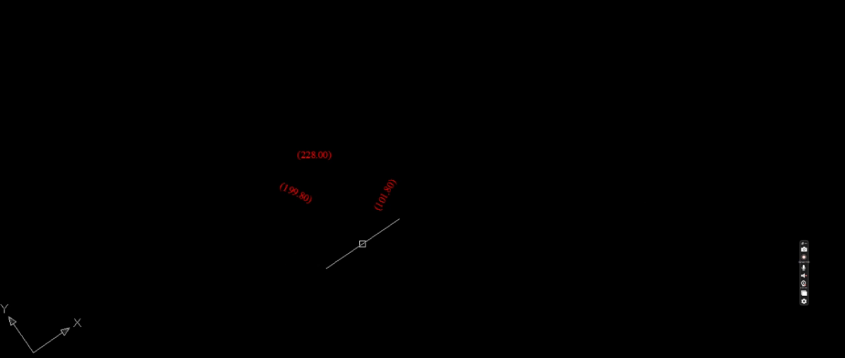

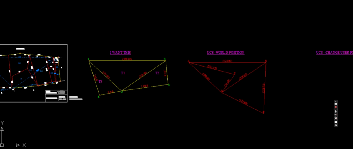

1) I want Triangle T1 T2 T3
2) I run program TRI command for T1 Triangle in UCS World position T1 Triangle is good for the shape and distance
3) I run program TRI command for T2 Triangle in  UCS World position T2 Triangle shape and distance is rong
    but text value is aligned to the object
4) I run program TRI command for T2 Triangle Change in  UCS "3" Point method T2 Triangle shape is            correct distance ,But text value is Outside of object

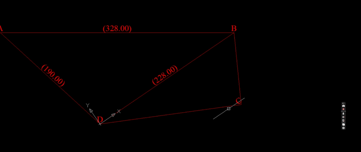

Yes creating a triangle and writing the distances of each line its on error  for triangle and distance i run program in wcs co-ordinates triangle and distance is error i change ucs triangle
and distance value is good  but text is mirror and rotate and font is bold
Just a comment re A B C you dont need to enter the values, 1st go is text1 nil ? If so set its character number to 65 just type (chr 65) and see what you get ! So set X to 65 the next character is (chr (+ x 1)) which is B, C will be (chr (+ x 2)). Hope you understand.
So draw 1st triangle starts with 65 and last is 67, then set first to X+1 second x+2 third X+3.
The only real limit is 26 characters A-Z
Edited by BIGAL
If you want try...

On 5/11/2023 at 6:58 PM, Tsuky said:
 i want change the text height  ex:  (setq th(getint "\n enter text height") )
(defun c:tri ( / TA TB TC cc1 r1 cc2 r2 dce dxf_210 xi yi i cr1 cr2 vi xt yt h1 h2 h i1 i2 key)
   (command "osmode" 1)
  (initget 9)
   (setq cc1 (getpoint "\nPick  specify start point?: "))
  (initget 9)
  (setq cc2 (getpoint cc1 "\nPick or specify end point?: "))
   (SETQ P1 (DISTANCE CC1 CC2))
  (setq th(getint "\n enter text height")) ; i want change text height
  (grdraw cc1 cc2 1)
 ; (SETVAR "users3" (RTOS P1 2 2))
  ;(vl-vbaload "E:/FMB Cadd/GUIDELINE.dvb");testdial
  ;(VL-VBARUN "LTV")
  (setq
    Tx (if (not Tx) 65 Tx)
    TA (getstring (strcat "\nEnter start point of text <" (chr Tx) ">: "))
  (if (not (eq TA "")) (setq Tx (1+ (setq TA (ascii TA)))) (setq TA Tx Tx (1+ Tx)))
  (setq TB (getstring (strcat "\nEnter end point of text <" (chr Tx) ">: ")))
  (if (not (eq TB "")) (setq Tx (1+ (setq TB (ascii TB)))) (setq TB Tx Tx (1+ Tx)))
  (setq TC (getstring (strcat "\nEnter third point of text <" (chr Tx) ">: ")))
  (if (not (eq TC "")) (setq Tx (1+ (setq TC (ascii TC)))) (setq TC Tx Tx (1+ Tx)))
  (initget 39)
  (setq r1 (getdist cc1 (strcat "\n" (chr TA) "<----->" (chr TC) " Length: ")))
  (initget 39)
  (setq r2 (getdist cc2 (strcat "\n" (chr TB) "<----->" (chr TC) " Length: ")))
  (grdraw cc1 cc2 0)
  (setq
    dce (distance cc1 cc2)
    dxf_210 (trans '(0 1 0) (getvar "UCSYDIR") 0)
  (if (equal (/ dce (+ r1 r2)) 1E-16)
    (setq
      xi (/ (+ (* r2 (car cc1)) (* r1 (car cc2))) dce)
      yi (/ (+ (* r2 (cadr cc1)) (* r1 (cadr cc2))) dce)
      i (cons xi (cons yi '(0.0)))
    (if (and (not (zerop (- r1 r2))) (equal (/ dce (+ r1 r2)) 1E-16))
        (if (= r1 (max r1 r2))
          (setq cr1 cc1 cr2 cc2)
          (setq cr1 cc2 cr2 cc1)
        (setq
          xi (/ (- (* (max r1 r2) (car cr2)) (* (min r1 r2) (car cr1))) dce)
          yi (/ (- (* (max r1 r2) (cadr cr2)) (* (min r1 r2) (cadr cr1))) dce)
        (if (or (> dce (+ r1 r2)) (< (+ (min r1 r2) dce) (max r1 r2)))
          (prompt "\nNo intersection !...")
            (setq vi (angle cc1 cc2))
            (if (> r1 r2)
              (setq
                xt (- (/ (* (+ r1 dce r2) (- (+ r1 dce) r2)) (* 2 dce)) r1)
                yt (- dce xt)
                h1 (sqrt (- (expt r1 2) (expt xt 2)))
                h2 (sqrt (- (expt r2 2) (expt yt 2)))
                xi (/ (+ (* yt (car cc1)) (* xt (car cc2))) dce)
                yi (/ (+ (* yt (cadr cc1)) (* xt (cadr cc2))) dce)
              (setq
                xt (- (/ (* (+ r2 dce r1) (- (+ r2 dce) r1)) (* 2 dce)) r2)
                yt (- dce xt)
                h1 (sqrt (- (expt r2 2) (expt xt 2)))
                h2 (sqrt (- (expt r1 2) (expt yt 2)))
                xi (/ (+ (* xt (car cc1)) (* yt (car cc2))) dce)
                yi (/ (+ (* xt (cadr cc1)) (* yt (cadr cc2))) dce)
            (setq
              h (/ (+ h1 h2) 2)
              i1 (polar (cons xi (cons yi '(0.0))) (+ vi (/ pi 2)) h)
              i2 (polar (cons xi (cons yi '(0.0))) (- vi (/ pi 2)) h)
            (princ "\n<Move cursor> for choice; <Enter>/[Space]/Right-Click for end!.")
            (while (and (not (member (setq key (grread T 4 2)) '((2 13) (2 32)))) (/= (car key) 25))
              (redraw)
              (grdraw cc1 cc2 7)
              (cond
                ((eq (car key) 5)
                  (if (< (distance i1 (cadr key)) (distance i2 (cadr key)))
                    (set 'i i1)
                    (set 'i i2)
                  (grdraw cc1 i 7)
                  (grdraw i cc2 7)
            (setq
              cc1 (trans cc1 1 dxf_210)
              cc2 (trans cc2 1 dxf_210)
              i (trans i 1 dxf_210)
            (entmake
              (list
                '(0 . "LWPOLYLINE")
                '(100 . "AcDbEntity")
                (cons 67 (if (eq (getvar "CVPORT") 1) 1 0))
                (cons 410 (if (eq (getvar "CVPORT") 1) (getvar "CTAB") "Model"))
                (cons 8 (getvar "CLAYER"))
                (cons 62 150)
                (cons 6 (getvar "CELTYPE"))
                (cons 370 (getvar "CELWEIGHT"))
                '(100 . "AcDbPolyline")
                '(90 . 3)
                (if (eq (getvar "PLINEGEN") 1) '(70 . 129) '(70 . 1))
                (cons 43 (getvar "PLINEWID"))
                (cons 38 (getvar "ELEVATION"))
                (cons 39 (getvar "THICKNESS"))
                (cons 10 (list (car cc1) (cadr cc1)))
                '(40 . 0.0)
                '(41 . 0.0)
                '(42 . 0.0)
                '(91 . 0)
                (cons 10 (list (car i) (cadr i)))
                '(40 . 0.0)
                '(41 . 0.0)
                '(42 . 0.0)
                '(91 . 0)
                (cons 10 (list (car cc2) (cadr cc2)))
                '(40 . 0.0)
                '(41 . 0.0)
                '(42 . 0.0)
                '(91 . 0)
                (cons 210 dxf_210)
	    (SETQ OBJ1(ENTLAST))(COMMAND "EXPLODE" OBJ1 "")
            (mapcar
              '(lambda (d a p / )
                (entmake
                  (list
                    '(0 . "TEXT")
                    (cons 8 "Some layer")
                    '(62 . 1)
                    '(100 . "AcDbText")
                    '(10 0.0 0.0 0.0)
                    '(40 . th)
                    (cons 1 (strcat "(" (rtos d 2 2) ")"))
                    (cons
                      50
                      (if (minusp (cos a))
                        (+ pi a)
                        a
                    '(72 . 1)
                    (cons 11 p)
                    (cons 210 dxf_210)
                    '(100 . "AcDbText")
                    '(73 . 1)
              (mapcar '(lambda (i / ) (distance (list (caar i) (cadar i)) (list (caadr i) (cadadr i)))) (list (list cc1 cc2) (list cc1 i) (list cc2 i)))
              (mapcar '(lambda (i / ) (angle (car i) (cadr i))) (list (list cc1 cc2) (list cc1 i) (list cc2 i)))
              (mapcar
                '(lambda (i / ) (list (* (+ (caar i) (caadr i)) 0.5) (* (+ (cadar i) (cadadr i)) 0.5)))
            (mapcar
              '(lambda (x p / )
                (entmake
                  (list
                    '(0 . "TEXT")
                    '(62 . 1)
                    '(100 . "AcDbText")
                    '(10 0.0 0.0 0.0)
                    '(40 . th)
                    (cons 1 (chr x))
                    '(50 . 0.0)
                    (cons 7 (getvar "TEXTSTYLE"))
                    '(72 . 1)
                    (cons 11 p)
                    (cons 210 dxf_210)
                    '(100 . "AcDbText")
                    '(73 . 1)
              (list TA TB TC)
              (list cc1 cc2 i)
            (redraw)
  (prin1)(command "osmode" 15359)
