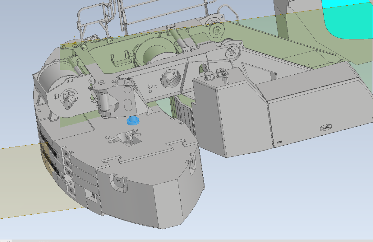

I'd like to add the counterweights into the original assembly file, but since they're from a different file, it looks like I need to constrain them to the original somehow.  I have no clue how to do that.  I've tried for a few hours each over the last 3 days and it just does not make sense to me.  I tried Mating the blue cylinder with the center line of the hole below it, then repeating for the same feature on the opposite side of the model... I've tried adding planes offset and midway and through points then constraining those to various features, all kinds of stuff except for apparently the correct stuff.  I keep getting it 'stuck' in place where it doesn't belong and/or getting messages about errors updating the model.  I understand that for some reason the combination of constraints I'm trying to do can't be done on this geometry, but I have no idea how to fix it.  The only thing I don't know is the correct vertical distance between the counterweights (Ballast_#:1) and the rest of the model (various Oberwagen_#:1 named pieces), but I can find that out.
Would anyone be willing to constrain the Ballast:1 items for me so that I can see how it can be done and try to learn from that?  The blue cylinder in the screenshot should line up with the obvious hole below; same thing happens on the opposite side.  I hate to ask, but I'm jsut at a loss and not making any progress, not learning anything.
