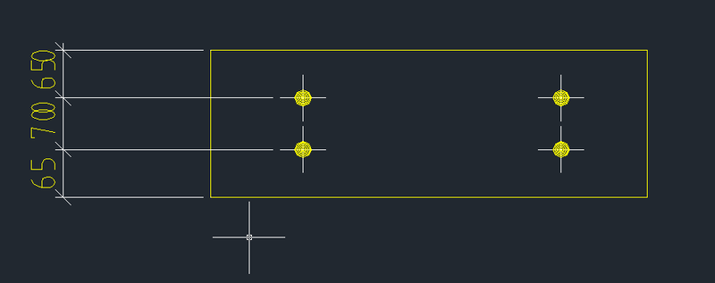

Tried this but somehow weird outputs especially for Right option.
Output for Left:
Output for Right:
Output for Top:
Output for Bottom:
