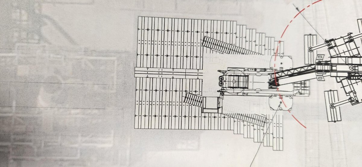

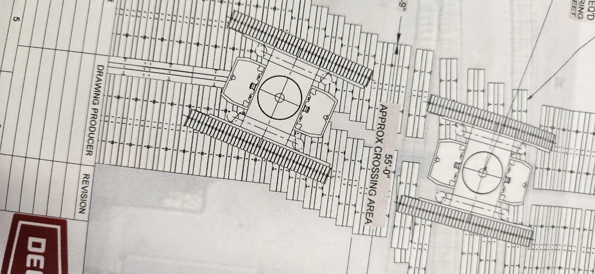

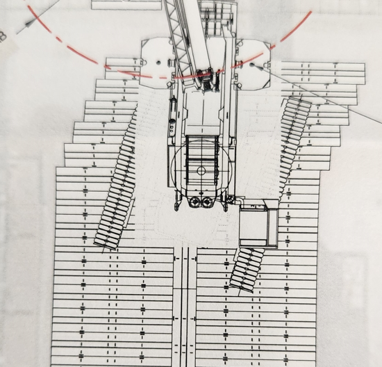

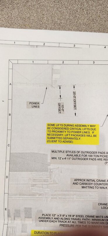

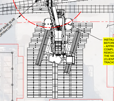

ColinPearson Posted April 25, 2023 Share Posted April 25, 2023 Hi Folks: I have some strange plotting issues recently, mainly since getting a new laptop at work that came with new versions of CAD and pdf software. ACAD Mechanical 2023 and Foxit PDF Editor Pro v11.2.2.53575 specifically. When I plot using the same settings I have used for years over numerous versions of Acrobat, Bluebeam and Foxit I get... a totally normal looking pdf. HOWEVER, when I print that to paper, there are many lines that are so faint you almost cannot see them and some Wipeouts that a) don't plot the same shape as teh actual Wipeouts from CAD or b) somehow wipe out some extra/adjacent area so the effect is something odd. See the attached pics... not all of them do it, but some do. I think you'll be able to tell the one that looks weird without having context for the drawing. Thanks y'all! Quote Link to comment Share on other sites More sharing options...

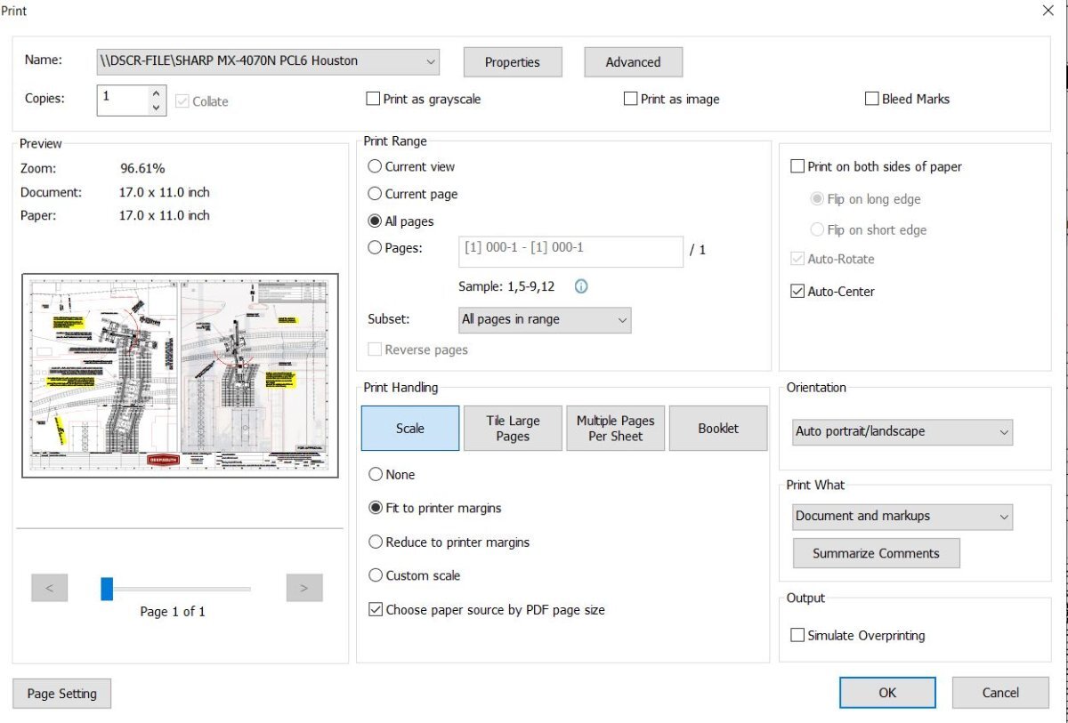

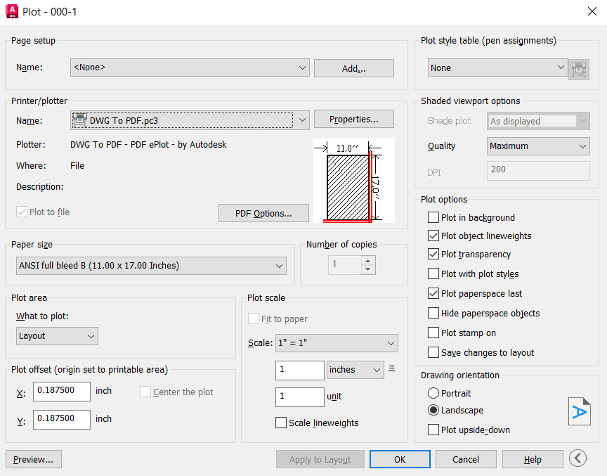

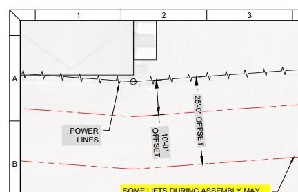

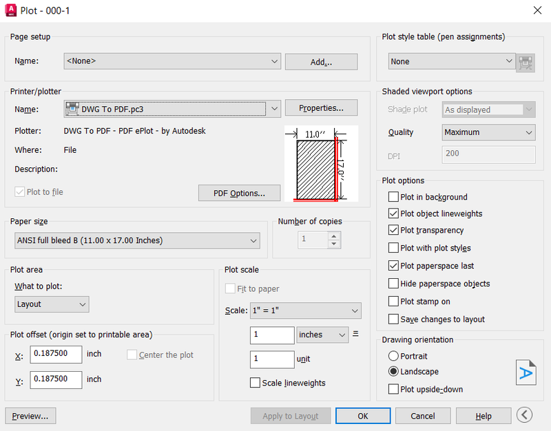

ColinPearson Posted April 26, 2023 Author Share Posted April 26, 2023 Maybe I'm not understanding what you're asking. I definitely appreciate taking the time to look into it. As far as I know, using "None plot style table (pen assignments)" means that I don't have anysort of .ctb or .stb set up. Here's my plot settings from CAD (image.png) Then in the pdf, I see what look like normal results to me, like the following (goodlines.jpg) Then when I print I get this (EVIL_lines.jpg) using the following print settings (foxit.jpg) THANKS!! Quote Link to comment Share on other sites More sharing options...

SLW210 Posted April 26, 2023 Share Posted April 26, 2023 If the PDF looks fine on screen, I would believe it is a PDF and/or plotter issue. How does it plot direct from AutoCAD? How does the PDF plot from another program besides Foxit? Quote Link to comment Share on other sites More sharing options...
ColinPearson Posted April 26, 2023 Author Share Posted April 26, 2023 Hi SLW210 - I had recently switched from veerrryyy thin lines to 0.00mm lines in the Layer Manager. Just a couple minutes ago, I changed to 0.09mm and they line work is looking better. I like hte look of 0.00mm but if my one problem can be solved with barely thicker lines then I can live with that. Even at 0.00mm, when I turn the image layer off in the Viewport, the line work looks good on pdf and on paper, so I think the 0.00mm lines are not playing nice with the image. I don't have another pdf software anymore that I could check. IT recently went through and moved us all from Acrobat + Foxit to just Foxit, and I don't even have enough admin rights to delete icons from damn desktop. (FML) The real rub to me is the Wipeouts printing crazy. They seem to just take out other stuff willy-nilly, see on-screen pdf and paper versions below: I actually have still been experimenting with the line weights. Now in MS I have 0.00mm and I have it set to 0.09mm in VP Lineweight, and I think this last printing I did about 30 seconds ago has everything resolved. Without understanding the issue, I hate to just drop it though. Does it makes sense to you that a 0.00mm Lineweight would make some (but not all) lines too faint to see and also do that weird Wipeout stuff above? Thanks again!! Quote Link to comment Share on other sites More sharing options...
CyberAngel Posted April 26, 2023 Share Posted April 26, 2023 I've always had trouble getting wipeouts to work properly. It seems to be a drawing order issue. They'll get out of order if they're inside a block or a viewport. Could that be part of your problem? Quote Link to comment Share on other sites More sharing options...
ColinPearson Posted April 26, 2023 Author Share Posted April 26, 2023 CyberAngel, I'm not sure, but I have a feeling it's related. The thing that I think is SO odd is that the 'kinda-wipeout' area in the printed version does not correspond to the shape of any actual Wipeout I have in my dwg file. I never used them much before because I had an issue years ago where I had a wipeout behind text (before I knew about Background Masks) and they would be black text over a white Wipeout in CAD, on my pdf, and on paper once I printed. but my general foreman printed the same file from his computer/printer and the wipeouts were solid black so you couldn't see the text. That was a confusing conversation when he asked WTH I had a drawing with no dimensions for LOL. Anyway, I do have a feeling that Draw Order could be part of this. Sometimes I have Viewports that will not refresh the Draw Order after I change items around Above/Behind others, but they will still plot with the correct Order, that's kinda odd to me. Quote Link to comment Share on other sites More sharing options...
