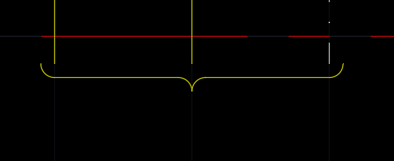

Lee Mac Posted April 21, 2023 Posted April 21, 2023 Here's another - (defun c:brace ( / ang blg di1 di2 mat rad pt1 pt2 ) (setq rad 1.0) ;; Brace radius (if (and (setq pt1 (getpoint "\nSpecify 1st point for brace: ")) (progn (while (and (setq pt2 (getpoint "\nSpecify 2nd point for brace: " pt1)) (< (distance pt1 pt2) (* 4 rad)) ) (princ "\nDistance between the two points must be greater than 4 times the radius.") ) pt2 ) ) (progn (setq di1 (distance pt1 pt2) di2 (- (/ di1 2.0) rad) ang (angle pt1 pt2) mat (list (list (cos ang) (- (sin ang))) (list (sin ang) (cos ang))) blg (1- (sqrt 2.0)) ) (entmake (append '( (000 . "LWPOLYLINE") (100 . "AcDbEntity") (100 . "AcDbPolyline") (090 . 7) (070 . 0) ) (apply 'append (mapcar (function (lambda ( a b ) (list (cons 010 (mapcar '+ (mapcar '(lambda ( r ) (apply '+ (mapcar '* r a))) mat) pt1)) (cons 042 b) ) ) ) (list '(0.0 0.0) (list rad (- rad)) (list di2 (- rad)) (list (+ di2 rad) (- 0 rad rad)) (list (- di1 di2) (- rad)) (list (- di1 rad) (- rad)) (list di1 0.0) ) (list blg 0.0 (- blg) (- blg) 0.0 blg 0.0) ) ) (list (cons 210 (trans '(0.0 0.0 1.0) 1 0 t))) ) ) ) ) (princ) ) To flip the brace, pick the points in the opposite direction. 5 Quote

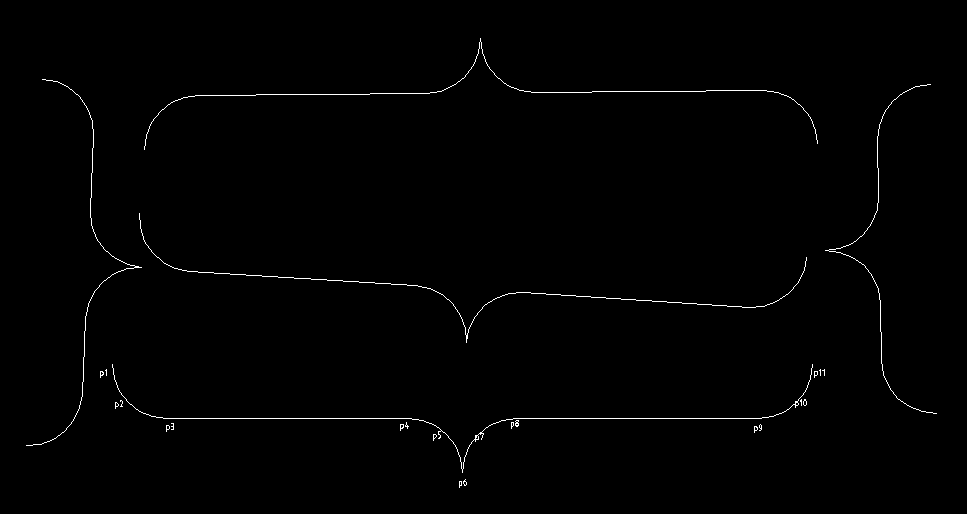

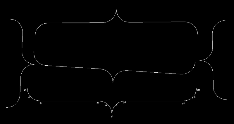

BIGAL Posted April 22, 2023 Posted April 22, 2023 (edited) Based on wall insulation code I have of straights and arcs using just the pline command with option of a "Arc" would be feasible also, though the code by lee would be hard to beat. May have a go also using plain pline commands. Could add radius options in a range like 0.5 - 2.5 but more than likely will be fixed. Another ; pline with arcs by AlanH April 2023 (defun c:wow ( / pt1 pt2 pt3 pt4 pt5 pt6 pt7 pt8 pt9 pt10 pt11 dist ang rad) (setq rad 1) (setq pt1 (getpoint "\nPick start point ")) (setq pt11 (getpoint pt1 "\nPick end point ")) (setq oldsnap (getvar 'osmode)) (setvar 'osmode 0) (setq ang (angle pt1 pt11)) (setq dist (distance pt1 pt11)) ; do like Lee check dist is long enough (setq pt2 (polar (polar pt1 ang rad) (+ ang (* 1.25 pi)) rad)) (setq pt3 (polar (polar pt1 ang rad) (- ang (/ pi 2)) rad)) (setq pt4 (polar pt3 ang (- (/ dist 2.0) (* 2.0 rad)))) (setq pt5 (polar (polar pt4 (- ang (/ pi 2.)) rad)(+ ang (* 0.25 pi)) rad)) (setq pt6 (polar (polar pt4 ang rad) (- ang (/ pi 2)) rad)) (setq pt7 (polar (polar pt6 ang rad) (+ ang (* 0.75 pi)) rad)) (setq pt8 (polar pt4 ang (* 2.0 rad))) (setq pt9 (polar pt8 ang (- (/ dist 2.0) (* 2.0 rad)))) (setq pt10 (polar (polar pt11 (+ pi ang) rad) (+ ang (* 1.75 pi)) rad)) (command "pLINE" pt1 "w" 0.0 0.0 "arc" "s" pt2 pt3 "L" pt4 "arc" "s" pt5 pt6 "arc" "s" pt7 pt8 "L" pt9 "arc" "s" pt10 pt11 "") (setvar 'osmode oldsnap) (princ) ) Edited April 22, 2023 by BIGAL 2 Quote

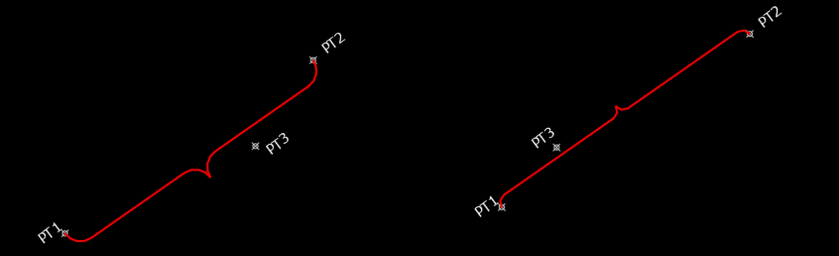

robierzo Posted April 22, 2023 Posted April 22, 2023 (edited) My grain of sand another. Selecting 3 points. The third point will be on one side or the other of the main alignment. The radius is equal to the distance from p3 to the line p1-p2/2 (defun punto_izda_dcha (p1 p2 p3 / a b c) (defun det3 (a b c) (+ (det2 b c) (det2 a b) (- (det2 a c))) ) (defun det2 (a b) (- (* (car a) (cadr b)) (* (car b) (cadr a))) ) (setq resultado (/ (det3 p1 p2 p3) 2)) ) (defun c:llave (/ pt1 pt2 pt3 dist_pt1_pt2 radio bulge p2aux p3aux p4aux p5aux p6aux area ang_perp) (if (= cal nil) (arxload "geomcal")) (setq pt1 (getpoint "\nIndica el punto 1: ")) (setq pt2 (getpoint "\nIndica el punto 2: ")) (setq pt3 (getpoint "\nIndica el punto 3: ")) (setq dist_pt1_pt2 (distance pt1 pt2)) (setq radio (/ (c:cal "dpl(pt3,pt1,pt2)") 2.)) (setq bulge (abs(- 1 (sqrt 2)))) (cond ((equal (c:cal "dpl(pt3,pt1,pt2)") 0.0 0.01) (setq radio (/ dist_pt1_pt2 8)) ) ((> (* (c:cal "dpl(pt3,pt1,pt2)") 4) dist_pt1_pt2) (setq radio (/ dist_pt1_pt2 4)) ) ) (setq p2aux (polar pt1 (angle pt1 pt2) radio)) (setq p4aux (mapcar '(lambda (x y) (/ (+ x y) 2)) pt1 pt2)) (setq p3aux (polar p4aux (angle pt2 pt1) radio)) (setq p5aux (polar p4aux (angle pt1 pt2) radio)) (setq p6aux (polar pt2 (angle pt2 pt1) radio)) (setq area (punto_izda_dcha pt1 pt2 pt3)) (if (< area 0) (setq ang_perp (+ (angle pt1 pt2) (* (/ pi 2)3))) (setq ang_perp (+ (angle pt1 pt2) (/ pi 2))) ) (setq p2 (polar p2aux ang_perp radio)) (setq p3 (polar p3aux ang_perp radio)) (setq p4 (polar p4aux ang_perp (* radio 2))) (setq p5 (polar p5aux ang_perp radio)) (setq p6 (polar p6aux ang_perp radio)) (entmake (list '(0 . "LWPOLYLINE") '(100 . "AcDbEntity") '(100 . "AcDbPolyline") '(90 . 7) '(43 . 0.25);grosor '(38 . 0.0);elevacion '(62 . 1);color por capa (list 10 (car pt1) (cadr pt1)) '(40 . 0.0) '(41 . 0.0) (if (< area 0) (cons 42 bulge) (cons 42 (- bulge))) (list 10 (car p2) (cadr p2)) '(40 . 0.0) '(41 . 0.0) '(42 . 0.0) (list 10 (car p3) (cadr p3)) '(40 . 0.0) '(41 . 0.0) (if (< area 0) (cons 42 (- bulge)) (cons 42 bulge)) (list 10 (car p4) (cadr p4)) '(40 . 0.0) '(41 . 0.0) (if (< area 0) (cons 42 (- bulge)) (cons 42 bulge)) (list 10 (car p5) (cadr p5)) '(40 . 0.0) '(41 . 0.0) '(42 . 0.0) (list 10 (car p6) (cadr p6)) '(40 . 0.0) '(41 . 0.0) (if (< area 0) (cons 42 bulge) (cons 42 (- bulge))) (list 10 (car pt2) (cadr pt2)) '(40 . 0.0) '(41 . 0.0) '(42 . 0.0) '(210 0.0 0.0 1.0) )) ) Edited April 22, 2023 by robierzo 1 Quote
Emmanuel Delay Posted April 25, 2023 Author Posted April 25, 2023 On 4/21/2023 at 5:43 PM, Lee Mac said: Here's another - (defun c:brace ( / ang blg di1 di2 mat rad pt1 pt2 ) (setq rad 1.0) ;; Brace radius (if (and (setq pt1 (getpoint "\nSpecify 1st point for brace: ")) (progn (while (and (setq pt2 (getpoint "\nSpecify 2nd point for brace: " pt1)) (< (distance pt1 pt2) (* 4 rad)) ) (princ "\nDistance between the two points must be greater than 4 times the radius.") ) pt2 ) ) (progn (setq di1 (distance pt1 pt2) di2 (- (/ di1 2.0) rad) ang (angle pt1 pt2) mat (list (list (cos ang) (- (sin ang))) (list (sin ang) (cos ang))) blg (1- (sqrt 2.0)) ) (entmake (append '( (000 . "LWPOLYLINE") (100 . "AcDbEntity") (100 . "AcDbPolyline") (090 . 7) (070 . 0) ) (apply 'append (mapcar (function (lambda ( a b ) (list (cons 010 (mapcar '+ (mapcar '(lambda ( r ) (apply '+ (mapcar '* r a))) mat) pt1)) (cons 042 b) ) ) ) (list '(0.0 0.0) (list rad (- rad)) (list di2 (- rad)) (list (+ di2 rad) (- 0 rad rad)) (list (- di1 di2) (- rad)) (list (- di1 rad) (- rad)) (list di1 0.0) ) (list blg 0.0 (- blg) (- blg) 0.0 blg 0.0) ) ) (list (cons 210 (trans '(0.0 0.0 1.0) 1 0 t))) ) ) ) ) (princ) ) To flip the brace, pick the points in the opposite direction. I'm rewriting this to do more general making of polylines with lines and arcs. Before asking the question I had something like this, where I would put extra bulge information in lst, and feed it to (cons 42). But this doesn't work. (defun drawLWPoly_arcs (lst cls) (entmakex (append (list (cons 0 "LWPOLYLINE") (cons 100 "AcDbEntity") (cons 100 "AcDbPolyline") (cons 90 (length lst)) (cons 70 cls) ) (mapcar (function (lambda (p) (cons 10 p) (cons 40 0.0) (cons 41 0.0) (cons 42 0.0) (cons 91 0) )) lst) ))) But I'll work further on something like this. I feed it an pointlist and bulge list ... (defun c:brace2 ( / pointlist bulgelist ang blg di1 di2 mat rad pt1 pt2) (setq rad 1.0) ;; Brace radius (setq pt1 (getpoint "\nSpecify 1st point for brace: ")) (setq pt2 (getpoint "\nSpecify 2nd point for brace: " pt1)) (setq di1 (distance pt1 pt2) di2 (- (/ di1 2.0) rad) ang (angle pt1 pt2) mat (list (list (cos ang) (- (sin ang))) (list (sin ang) (cos ang))) blg (1- (sqrt 2.0)) ) (setq pointlist (list '(0.0 0.0) (list rad (- rad)) (list di2 (- rad)) (list (+ di2 rad) (- 0 rad rad)) (list (- di1 di2) (- rad)) (list (- di1 rad) (- rad)) (list di1 0.0) ) ) (setq bulgelist (list blg 0.0 (- blg) (- blg) 0.0 blg 0.0) ;;(list blg 0.0 blg blg 0.0 blg 0.0) ) (princ mat) (entmake_points_bulges_list pt1 mat pointlist bulgelist) (princ) ) (defun entmake_points_bulges_list (pt1 mat pointlist bulgelist / ) (progn (entmake (append '( (000 . "LWPOLYLINE") (100 . "AcDbEntity") (100 . "AcDbPolyline") (090 . 7) (070 . 0) ) (apply 'append (mapcar (function (lambda ( a b ) (list (cons 010 (mapcar '+ (mapcar '(lambda ( r ) (apply '+ (mapcar '* r a))) mat) pt1)) (cons 042 b) ) ) ) pointlist bulgelist ) ) (list (cons 210 (trans '(0.0 0.0 1.0) 1 0 t))) ) ) ) (princ) ) So may thanks. Same for the rest of you. I'll find useful bits I can use for later projects. Quote
Lee Mac Posted April 25, 2023 Posted April 25, 2023 Why did you remove all of the error handling for the user input? Quote
Emmanuel Delay Posted April 25, 2023 Author Posted April 25, 2023 I'll put it back. I wanted to first see what's the minimum parameters the second function needs. Isolate the brace from the entmaking of the polyline, and have it run. Quote
BIGAL Posted April 26, 2023 Posted April 26, 2023 (edited) Doing the entmake with bulges to me was complicated v's working out points and making a pline. Speed is not a problem, a simple pline. Can add radius input etc as you should know with a dcl it keeps last value entered as current press Ok to keep going, when repeated. Edited April 26, 2023 by BIGAL Quote
