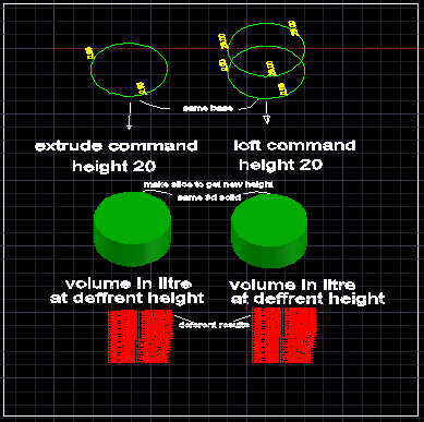

motee-z Posted April 18, 2023 Author Share Posted April 18, 2023 Also autocad2024 gives wrong value for volume .comparing value volume with real volume in addition to if you move the 3d solid to another insertion point you will get different volume result any one can check and he will see the same Quote Link to comment Share on other sites More sharing options...

motee-z Posted April 18, 2023 Author Share Posted April 18, 2023 (edited) same 3d solid but created in 2 method gives deferent volume any one know the reason 2wayvolume.dwg Edited April 18, 2023 by motee-z Quote Link to comment Share on other sites More sharing options...
ronjonp Posted April 18, 2023 Share Posted April 18, 2023 Massprop reports different as well. 2wayvolume.dwg Quote Link to comment Share on other sites More sharing options...
marko_ribar Posted April 19, 2023 Share Posted April 19, 2023 I draw circle with radius 10.0 and copied it little right not to overlap... Then I've changed view to sw iso... I've copied one circle 10.0 units above second circle, then I used loft cross sections and it created cylinder... First circle I've extruded 10.0 and also got cylinder... Finally I've used my BBox.lsp and everything was right - height on both of them was 10.0 not smaller not bigger... Only thing with lofted one is it left grip for changing loft surface generation which I left untouched... Quote Link to comment Share on other sites More sharing options...
motee-z Posted April 19, 2023 Author Share Posted April 19, 2023 thanks marko for reply my goal is to check volume for same 3d solid created in 2 method and comape results with the calucated one in mathematic(base area* height) when using splines or 2 dpolylines thanks Quote Link to comment Share on other sites More sharing options...
marko_ribar Posted April 19, 2023 Share Posted April 19, 2023 splines can be 2nd degree, but little tricky to (entmake) them... 2dpolylines have to have arced segments in forming circular shape... Normally with command SPLINE - CAD generates 3rd degree curve - not desired for this task... Else should be normal to realize Volume=base x height... Quote Link to comment Share on other sites More sharing options...
