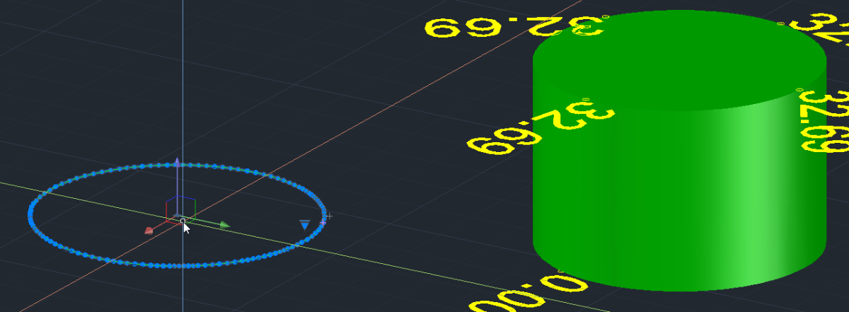

motee-z Posted April 14, 2023 Share Posted April 14, 2023 hello freinds i am looking to solve the problem with this 3d solid why it gave me wrong value for maximum height when applying getbondinbox it must gave me 32.69 not 32.909 any help will be appreciated (defun c:hv (/ lowestp higestp lvmin lvmax ) (vl-load-com) (setq osmd(getvar"osmode")) (setq Ent (entsel "\nCommand: Select a solid : " )) (setq Obj (vlax-ename->vla-Object (car Ent )) ) ;;;;;;;;;;;;;;;;;;;;;;;;;;;;;;;;;;;; (vla-GetBoundingBox obj 'minp 'maxp) (SETQ LOWESTP(vlax-safearray->list minp)) (setq higestP(vlax-safearray->list maxp)) (setq lvmin(caddr(vlax-safearray->list minp))) (setq lvmax(caddr(vlax-safearray->list maxp))) (print (strcat"maximum height"(rtos lvmax 2 3))) ) sample.dwg Quote Link to comment Share on other sites More sharing options...

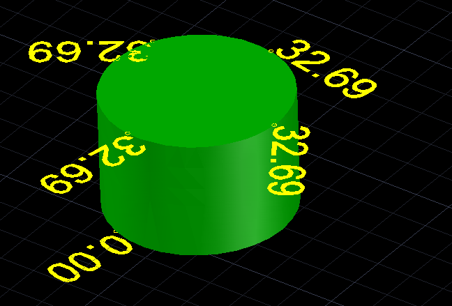

pkenewell Posted April 14, 2023 Share Posted April 14, 2023 17 minutes ago, motee-z said: why it gave me wrong value for maximum height when applying getbondinbox it must gave me 32.69 not 32.909 I just measured your sample drawing with the DISTANCE command and it is indeed 32.69, NOT 32.909. Quote Link to comment Share on other sites More sharing options...
motee-z Posted April 14, 2023 Author Share Posted April 14, 2023 (edited) yes it is 32.69 but if you apply the lisp to get maximum height it gave 32.909 if slice the 3d solid to known level and get new 3d solid and measure it height you will not get the same level of the known level Edited April 14, 2023 by motee-z Quote Link to comment Share on other sites More sharing options...

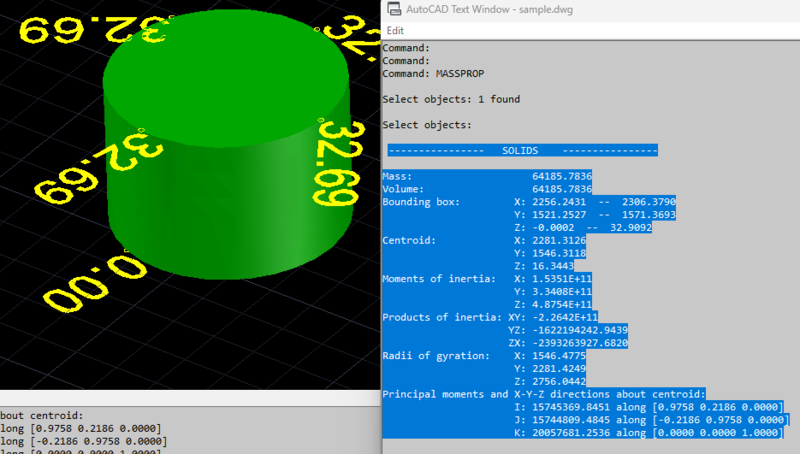

motee-z Posted April 15, 2023 Author Share Posted April 15, 2023 (edited) thanks rojonp for response is my code wrong also it gave me wrong value from your code ((2256.24 1521.25 -0.00019217) (2306.38 1571.37 32.9092)) Edited April 15, 2023 by motee-z Quote Link to comment Share on other sites More sharing options...
motee-z Posted April 15, 2023 Author Share Posted April 15, 2023 I noticed that all 3d solids formed from 3p poline when created and after one slice the rest of it gives wrong bonding box please check to slice any 3d solid created in this way Quote Link to comment Share on other sites More sharing options...

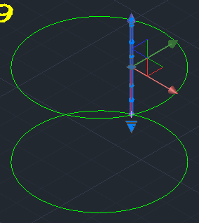

ronjonp Posted April 15, 2023 Share Posted April 15, 2023 (edited) It looks like this cylinder was made from a SPLINE and the bounding box method is known to give wonky results with splines. <- This is true but not your issue. Further investigation after exploding the solid and there is a vertical spline that is part of the solid that is 32.6901 tall. Too many numbers here I read your post closer and you state that the lisp gives a different height of 32.909 but I cannot reproduce that. Edited April 15, 2023 by ronjonp Quote Link to comment Share on other sites More sharing options...
motee-z Posted April 16, 2023 Author Share Posted April 16, 2023 may the defference due to autocad version i tested your lisp in autocad 2016 and 2019 and the result stay 32.909 Quote Link to comment Share on other sites More sharing options...
ronjonp Posted April 16, 2023 Share Posted April 16, 2023 34 minutes ago, motee-z said: may the defference due to autocad version i tested your lisp in autocad 2016 and 2019 and the result stay 32.909 Possibly. I'm running AutoCAD 2024. Quote Link to comment Share on other sites More sharing options...
marko_ribar Posted April 16, 2023 Share Posted April 16, 2023 Only after Ron's (c:hv) it gave me : 32.909, but when I used LIST it gave 32.69... I tested on AutoCAD 2022... Quote Link to comment Share on other sites More sharing options...
marko_ribar Posted April 16, 2023 Share Posted April 16, 2023 BricsCAD V23 is all OK... : (defun c:hv (/ ent minp maxp) (_> (vl-load-com) (_> (if (setq ent (entsel "\nSelect a solid : ")) ((_> (progn (setq obj (vlax-ename->vla-object (car ent))) (((_> (vla-getboundingbox obj 'minp 'maxp) (((_> (print (mapcar 'set '(minp maxp) (mapcar 'vlax-safearray->list (list minp maxp)))) (((_> ) ((_> ) (_> (princ) (_> ) C:HV : hv Select a solid : ((2256.29851751835 1521.30442645886 0.0) (2306.31287434778 1571.32444848864 32.6900909070525)) : li Select entities to list or [SOrt/Tracking/add to set (+)/subtract from set (-)/Previous selection/select by PROperties.../selection methoDs.../selection options (?)]: Entities in set: 1 Select entities to list or [SOrt/Tracking/add to set (+)/subtract from set (-)/Previous selection/select by PROperties.../selection methoDs.../selection options (?)]: ---------- 3dsolid ------------------------------------------------ Handle: 26F Current space: Model Layer: 0 Color: green Linetype: ByLayer Bounding Box: Lower Bound: X= 2256.2985 Y= 1521.3044 Z= 0.0000 Upper Bound: X= 2306.3129 Y= 1571.3244 Z= 32.6901 Quote Link to comment Share on other sites More sharing options...
marko_ribar Posted April 16, 2023 Share Posted April 16, 2023 (edited) But MASSPROP in BricsCAD V23 is also wrong : : MASSPROP Select entities [selection options (?)]: Entities in set: 1 Select entities [selection options (?)]: ---------------- SOLIDS ---------------- Mass: 64195.7546 Volume: 64195.7546 Bounding Box: Lower Bound: X= 2256.2431 Y= 1521.2527 Z= -0.0002 Upper Bound: X= 2306.3790 Y= 1571.3693 Z= 32.9092 Centroid: X= 2281.3150 Y= 1546.3123 Z= 16.3456 Moments of inertia: X= 153530185995.5973 Y= 334133168157.8903 Z= 487617616668.8713 Products of inertia: XY: 226458570281.5990 YZ: 1622571115.1894 ZX: 2393822783.8555 Radii of gyration: X= 1546.4780 Y= 2281.4273 Z= 2756.0465 Principal moments and X-Y-Z directions about centroid: I: 15746892.1549 along X= 0.7527 Y= -0.6583 Z= 0.0002 J: 15749203.2724 along X= 0.6583 Y= 0.7527 Z= 0.0002 K: 20061973.0658 along X= -0.0003 Y= 0.0000 Z= 1.0000 Edited April 16, 2023 by marko_ribar Quote Link to comment Share on other sites More sharing options...
motee-z Posted April 16, 2023 Author Share Posted April 16, 2023 any one can get z maximum value from the list property it seems correct but bounding box is wrong in all version of autocad ecxept version 2024 Quote Link to comment Share on other sites More sharing options...

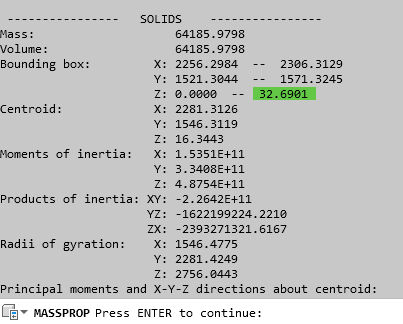

marko_ribar Posted April 16, 2023 Share Posted April 16, 2023 You are right Ron, I've just installed AutoCAD 2024 and it showed 32.69 in every case discussed... (c:hv), list, massprop... Quote Link to comment Share on other sites More sharing options...
ronjonp Posted April 17, 2023 Share Posted April 17, 2023 19 hours ago, marko_ribar said: You are right Ron, I've just installed AutoCAD 2024 and it showed 32.69 in every case discussed... (c:hv), list, massprop... Interesting .. I wonder if service packs for the older versions would correct this. Quote Link to comment Share on other sites More sharing options...

ronjonp Posted April 17, 2023 Share Posted April 17, 2023 I just tested your original drawing on AutoCAD 2022 .. same as Marko's result 32.909. AutoCAD 2023 give the same results as AutoCAD 2024. Quote Link to comment Share on other sites More sharing options...
