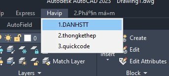

bunhoc_hh Posted April 10, 2023 Share Posted April 10, 2023 So i make some lisp-cover them to fas. Put all in 1 folder and make 1 mnu file that load with menuload and load all that lisp. But now i want put that in USB and when i load it to autocad, whatever i click in any lisp i want password showup then when i enter password i can use all fuction of it. Every time i open autocad and use them i need reenter password. Any change i can make that? Quote Link to comment Share on other sites More sharing options...

bunhoc_hh Posted April 10, 2023 Author Share Posted April 10, 2023 5 hours ago, Steven P said: You want a one time password entry? I think you'll have to look into creating a registry key and reading that to check if a password has been used. Note that if you read or modify the wrong thing you can change other settings so make sure what you use is unique it isn't something I do, but others out there could help The other option is one level less secure but perhaps easy to implement, and that is to save a small text file on the users machine containing some text (such as 'password OK") which if the file exists then the LISP can run, and if it doesn't exist, ask for the password. This file could be anywhere of course and if the coding is in the compiled code tricky to find by casual looking. Thank sir. I think registry key is what i looking for, just say when i click on 1.DANHSTT or any alert showup and i need enter password. After that i can use all function of menu lisp that i make. Every time you plug USB back it will ask password again, some thing like company USB when you need your personal password to enter computer. Can you show me some tutorial on youtube or any web doing this? Quote Link to comment Share on other sites More sharing options...
