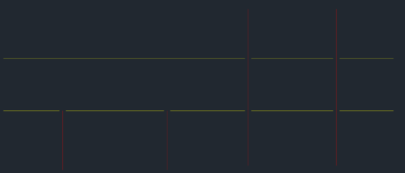

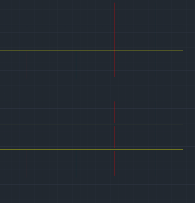

marko_ribar Posted April 10, 2023 Share Posted April 10, 2023 (edited) @barristann Have you checked my version... All you have to do is answer "Yes" if highlighting of lines match what you want, or "No" if highlighting of lines don't match what you want... Should be no syntax error... Though I've checked only in BricsCAD V23... [EDIT] Checked also in AutoCAD 2022 and it worked like should [/EDIT] Edited April 10, 2023 by marko_ribar 1 Quote Link to comment Share on other sites More sharing options...

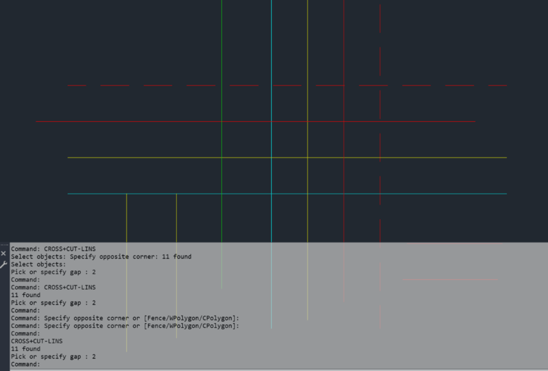

Tsuky Posted April 10, 2023 Share Posted April 10, 2023 @barristann I edited the previous code. You select all your lines concerned You will have the option to cut either with the verticals or with the horizontals. I also added the option of the gap (which can be 0.0) 1 Quote Link to comment Share on other sites More sharing options...
marko_ribar Posted April 10, 2023 Share Posted April 10, 2023 OK Tsuky, my gap can also be 0.0... Thanks for an idea... 1 Quote Link to comment Share on other sites More sharing options...

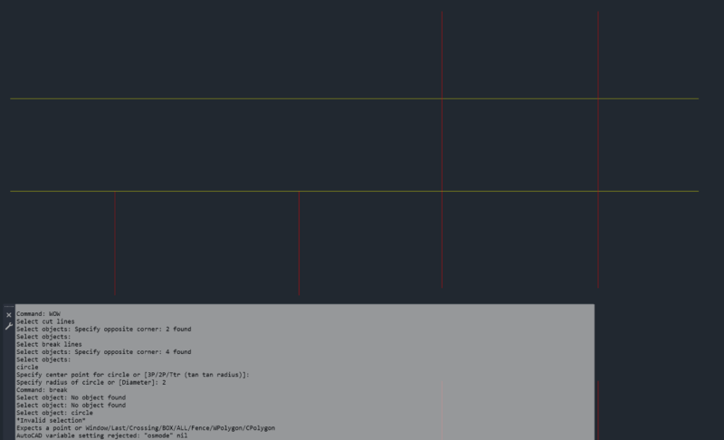

barristann Posted April 11, 2023 Author Share Posted April 11, 2023 (edited) marko_ribar, for some reason my AutoCAD 2021 isn't working. The command stops everytime I enter the Gap = 2 I'll do my best to see what's wrong with my computer. Thank you for your help marko_ribar. Edited April 11, 2023 by barristann Quote Link to comment Share on other sites More sharing options...
barristann Posted April 11, 2023 Author Share Posted April 11, 2023 (edited) Tsuky, I love your updated codes. I've just tested them. They work great! I'm astonished by your lisp skill Tsuky. These codes will save me so much time! instead of hours, it now take only few seconds . Wow amazing. Thank you Tsuky. Edited April 11, 2023 by barristann Quote Link to comment Share on other sites More sharing options...
