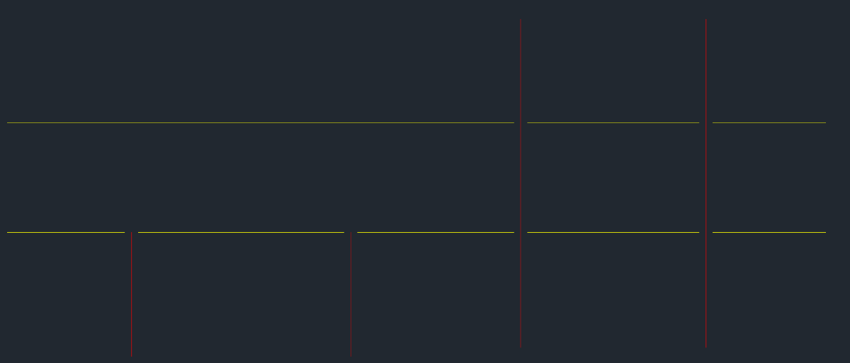

Hi all, is it possible to modify this to only Gap other Lines that are CROSSING (the selected Lines). The below will do this if they are just Touching, I need them to actually Cross one another

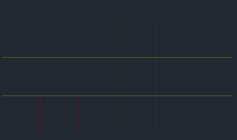

Thanks for replying devitg. For example, if I choose both Yellow Lines as the Cutter
Then this is what happen, it also cut the 2 Red Lines on the Left that are only Touching
Is it possible to modify this so that they only cut the 2 Red Lines on the Right that are Crossing?
Thank you
Expand
@barristann Find attached your image as dwg .
I put cutting lines on YELLOW layer, and cut lines on RED layer . It will be a good way to make selections .  Please add or change as you need to . Example the GAP  distance to cut  .
Please upload it in ACAD version 2019 , as I have not 2020
Also state the gap distance, and  if they are lines and or polylines . Please draw some more representatives entities.

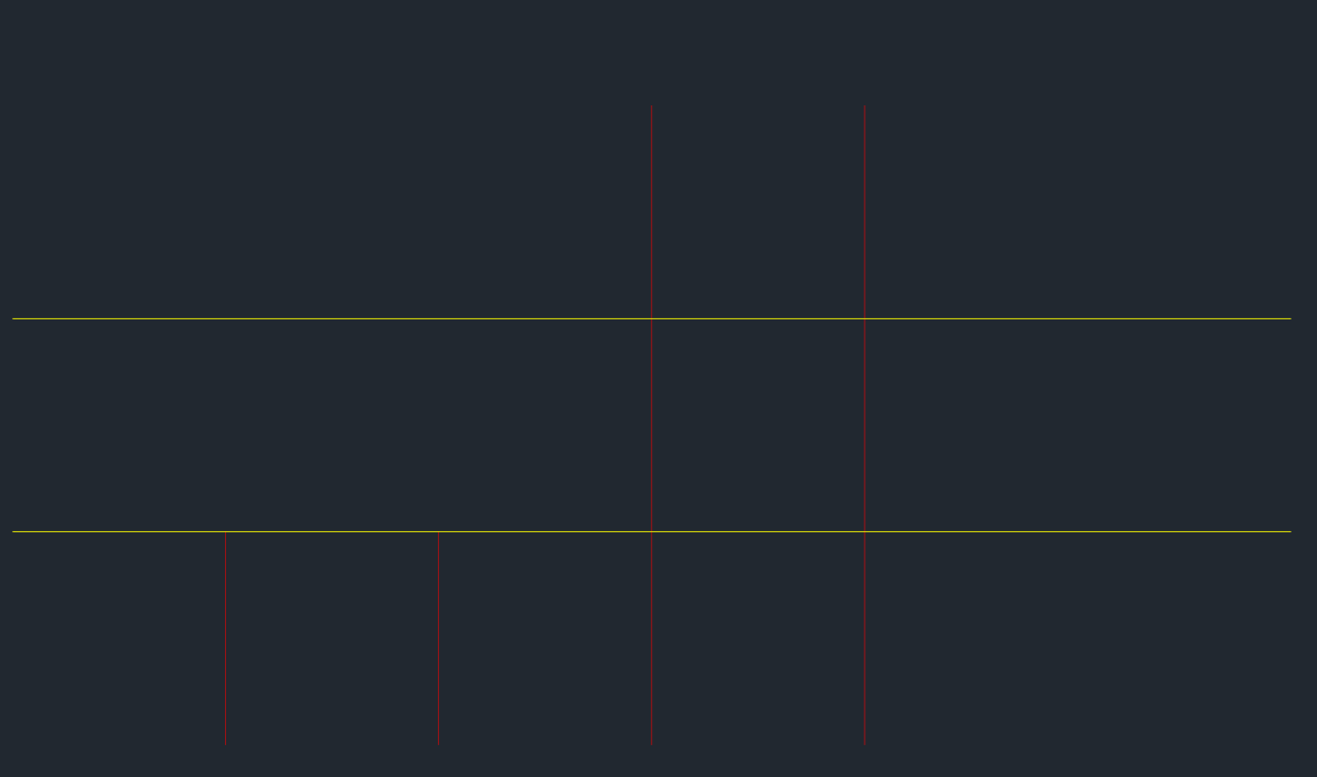

  On 4/9/2023 at 3:02 PM, barristann said:
I hope this is okay now

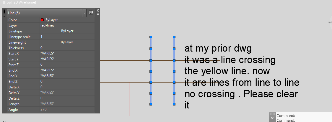

@barristann No. it are all lines , no crossing the yellow line . Please make a new dwg , use this one as template, in the real case

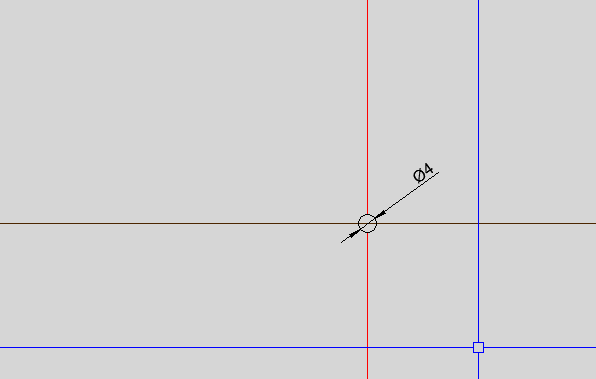

Like others doing something, there is an alternative to breaking the lines and that is to use a wipeout and play with draw order. The advantage is that the line is not broken but appears to to be. Can do something if that is helpful.
Another attempt, select cut P/lines, then select P/lines to break.
; Break p/lines at intersection
; By AlanH April 2023
(defun c:wow ( / x y ss1 ss2 obj1 obj2 obj intpt inpts)
(prompt "Select cut lines ")
(setq ss1 (ssget '((0 . "LWPOLYLINE,LINE"))))
(princ "\n")
(prompt "Select break lines ")
(setq ss2 (ssget '((0 . "LWPOLYLINE,LINE"))))
(setvar 'osmode 0)
(repeat (setq x (sslength ss1))
(setq obj1 (vlax-ename->vla-object (ssname ss1 (setq x (- x 1)))))
  (repeat (setq y (sslength ss2))
    (setq obj2 (vlax-ename->vla-object (ssname ss2 (setq y (- y 1)))))
    (setq intpt (vlax-invoke obj2 'intersectWith obj1 acExtendThisEntity))
    (if intpt
     (command "circle" intpt 4) ; can add a set gap
     (setq obj (vlax-ename->vla-object (entlast)))
     (setq intpts (vlax-invoke obj2 'intersectWith obj acExtendThisEntity))
     (entdel (entlast))
     (command "break" (list (car intpts)(cadr intpts)) (list (nth 3 intpts)(nth 4 intpts)))
(setvar 'osmode oldsnap)
(c:wow)

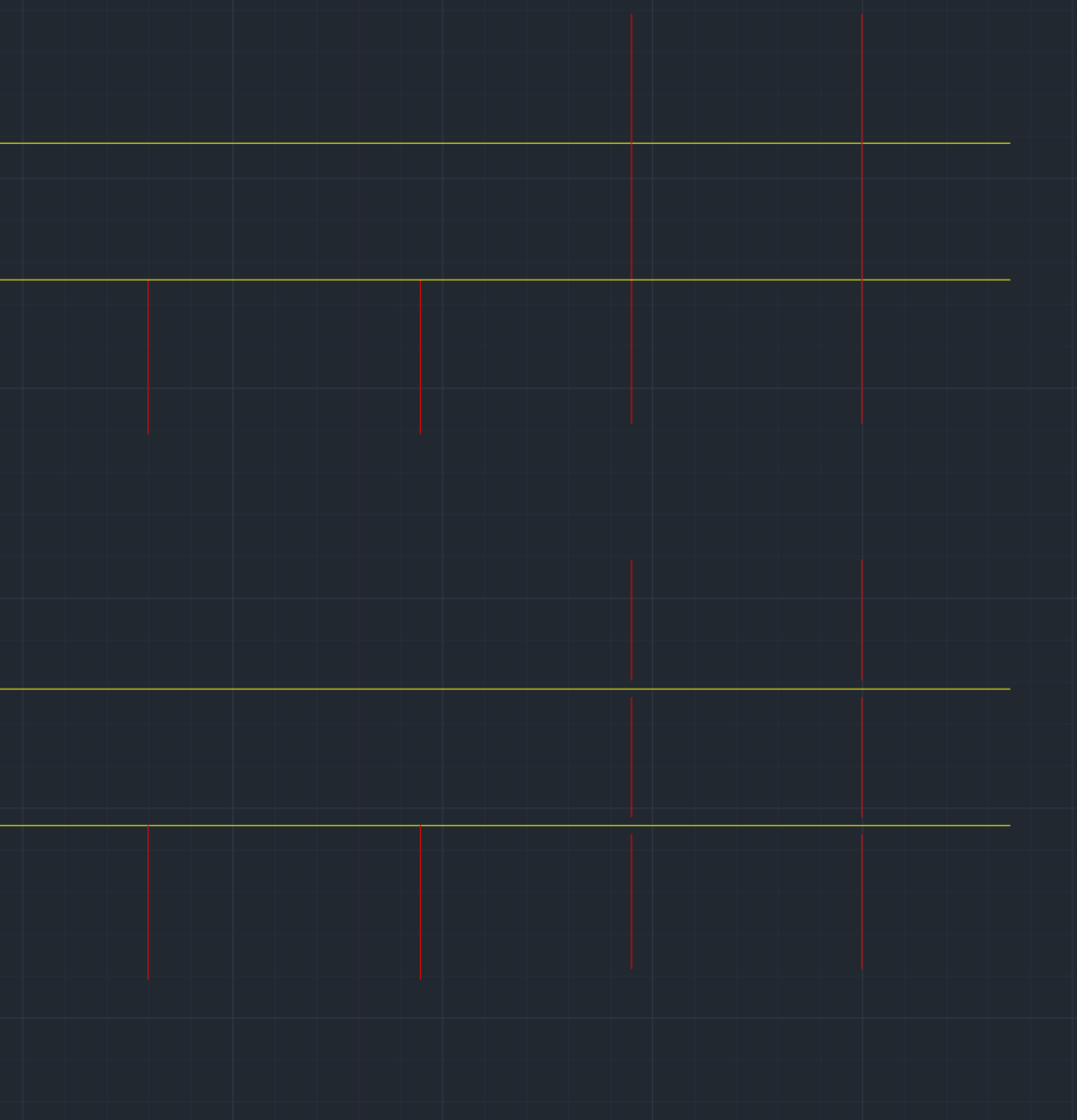

Thank you BIGAL, your codes are the best so far. I'll definitely use them. I just have to be careful with my selection. For example
1) If I also accidentally select the 2 Red Lines on the Left as "Select break lines", then nothing will happen
            - 2 Yellow for "Select cut lines"
            - 4  Red for "Select break lines"
Is it possible to ignore the 2 Left Red Lines (if I accidentally select them) but still process the 2 Right Red Lines?
2) Also, if I SWITCH my selections
            - 4 Red for "Select cut lines"
            - 2 Yellow for "Select break lines",  this is the result
The 2 Left Red is gapping the Yellow, even though it's just touching
Anyways, it works if I'm careful about my selection, I was hoping to full automation. Again, I'm still very grateful for your codes, BIGAL. I'll be using them since they're best I've seen so far. Thank you BIGAL.

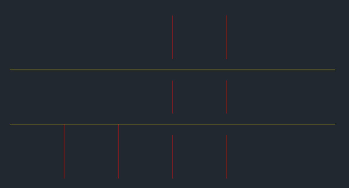

I agree BIGAL. Tsuky, your codes work! It ignores lines that are just touching. Thank you Tsuky!
Now, is it possible to update this so that:
1) if we select some Horizontal Lines as the Cutters, these will gap ALL Intersecting Vertical Lines on screen? (So we don't need to select the Vertical Lines)
2) Vice versa. if we select some Vertical Lines as the Cutters, these will gap ALL Intersecting Horizontal Lines on screen?
Sorry If I'm asking too much. If it's not possible then It's okay. Your codes still work great Tsuky. Thanks again.
