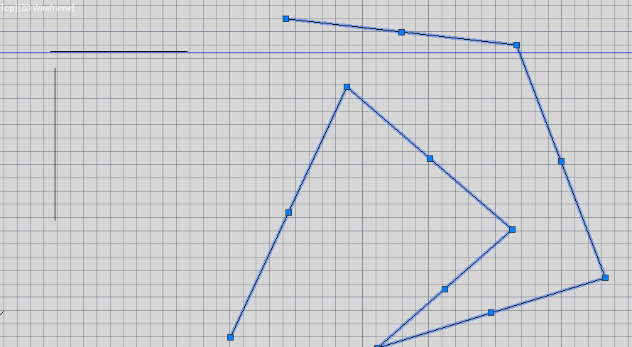

Can this routine be revised to select only the lines that are not Vertical or Horizontal.  Just lines that are not 0, 90, 180, 270 degrees. My skills are limited and what I tried did not work out.

@GolferRob  here you have , you can chose  Ver-Hor- Both-none , none by default

@devitg FWIW the code could be simplified like so using (REM ANGLE PI)

  (if (and (setq s (ssadd)) (setq ss (ssget "_X" (list '(0 . "LINE") (cons 410 (getvar 'ctab))))))

Thank you for the reply. It was exactly what I was looking for. Just made a few tweaks for layers and line types for my application.
