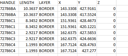

I have the following Lisp, it returns coordinates of poly lines and their lengths. The lisp is printing the coordinate's of each polyline's node, I would like this to return Just the length of each poly line. If anyone could also help me add an additional column that counts the number of polylines in 10's. (first polyline would be 10, second poly line 20, third poly line 30, and so on) Thanks you so much!! Ive included a picture of the output im currently getting with the doubled up values.

In this LISP you are creating a CSV file, comma separated data, which as far as LISP is concerned is just a text file - and knowing this helps you along the way/
To modify or create a text file the LISP uses the command "write-line" to well, write each line of the text / CSV file
For example, your header row is created using this:
(write-line "HANDLE,LENGTH,LAYER,X,Y,Z" F)
You could modify that line to be:
(write-line "HANDLE,LENGTH" F)
So look through the rest of the code for all the "write-lines"
These all have the format: (copying the line before as well)
    (setq tmp (strcat txt (rtos (car pnt) 2) "," (rtos (cadr pnt) 2) ",0.0"))
    (write-line tmp f)
"write-line tmp f" writes the variable tmp to the text file. Looking at tmp, strcat is like excel concatenate, joins text strings together, so tmp is the variable txt, and some stuff done to variable pnt - which I guess is 'point'
So go back up the code a bit, txt is defined once:
(setq txt (strcat han "," len "," lyr ","))
So what to do.....
Modify the header row as above. "Handle,Length"
and just before the (write-line tmp f) line just put (setq tmp txt), noting I also comment out (add ;;) the original setq tmp line - just so you can go back to the original if needed
;;    (setq tmp (strcat txt (rtos (car pnt) 2) "," (rtos (cadr pnt) 2) ",0.0"))
    (setq tmp txt)
    (write-line tmp f)
Right now adding in the count.
You'll want to set a counter somewhere in this. the code has a 'repeat' command, perhaps before then put in a line such as
(setq acount 0)
Then the first line after repeat increment this as you want
(setq acount (+ acount 10))
then work out how to modify the header to show the acount (look earlier in this answer), and also how to add this to the correct part of the variable tmp (perhaps looking at the strcat line above for a hint)
see how that works and ask again if you need more info.... long weekend break here so no CAD nut I can give you hints rather than a finished LISP

Hi Steve, Thank you for the help thus far. I have one last request. I used your code and was able to get the Handle, and Length to display on my excel file.
I would like just one last column displayed in the excel file and that is the X coordinate associated with the polylines (all of the polylines are vertical so the X doesn't change between the nodes in each polyline). Also, it seems the code is still outputting two of the same lengths for each polyline. Here is what I have currently which is just what I copied from you

We still don't see where you use "acount" variable... And if you need consecutive additions, move (setq acount 0) before complete (repeat loop...
EDIT - Had another thought
Try this, I've put the code in 'code tags', press the '<>' button and paste code in the pop up to do that.
In this version I have added in the count - you had the code in there but just not quite the right place, and added the count into the data line (see my comments what I added / took away and where)
For the duplicated line lengths, the code was putting in a line for the last point in a line / polyline / spline, so I have taken that out to give just the start 'X' coordinate
Final things, test this and try it out, then you can perhaps delete all the lines that are commented out (those that start with ;;, lines starting with a single ; I'd leave in though ) and also have a read through and ask if you want to find out what it all does.
