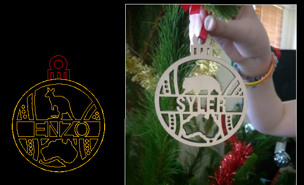

You need something like TEXT2GEOM by Seant this explodes the text into lines arcs etc that can then be joined together to make plines, ok next step is to make a solid say 1mm thick then subtract all the text form the solid, last step STLOUT. This is one I made a christmas bauble.

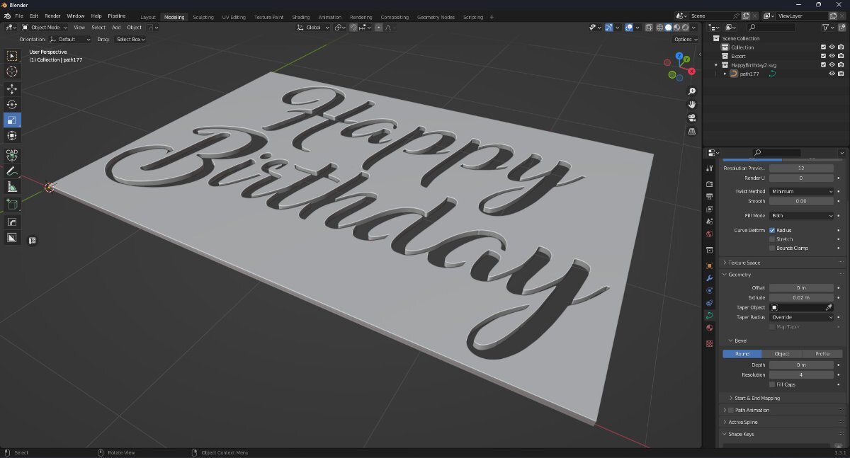

Another option would be to use some free programs.
1. Krita or Gimp to convert the image to black and white
2. Inkscape to create a scalable vector graphic
3. Blender to create the 3D model and then export to .stl format for printing
The model below was a quick and dirty attempt. I spent about 1 minute in each of the programs listed above. There are some kinks and indents within the lettering, due to the image quality, but those defects could be cleaned up within the image editing software or within Blender to smooth out the rough spots.

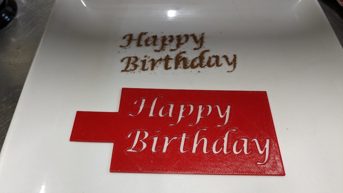

I ended up finding an STL file online and printing this out which my chef friend tried last night and was happy with the result but I think I prefer the font in the original one that you have used.
