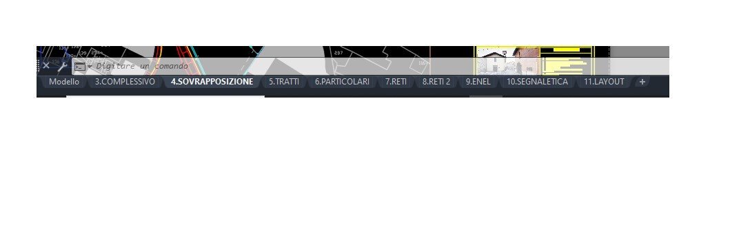

I made a file with a model space and some loyouts, the file became very cluttered and slowed down. They told me that it is possible to make one file of the model only and connect all the logouts in another file to lighten everything. How do I go about creating file links?

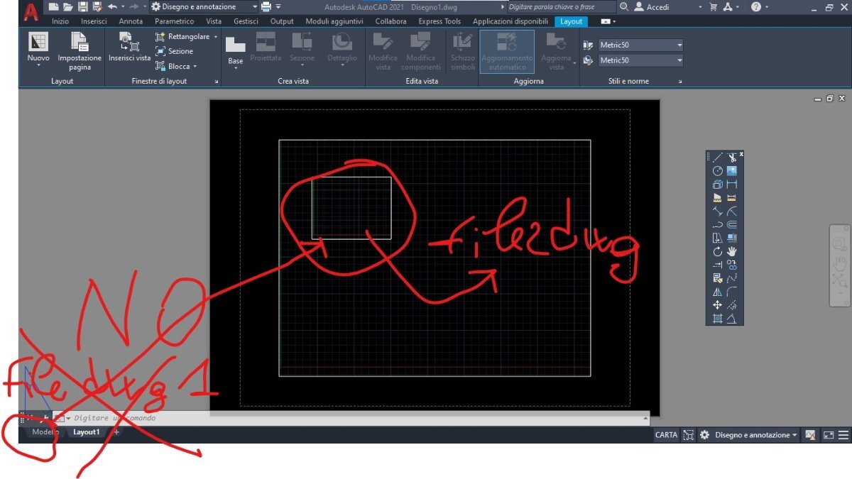

I want to enter this layout and when I open a window I want to see another dwg file and not the same file.

I don't understand how do you open a viewport rectangle in layout space in the same layout. If I open a window rectangle in the layout do I see the model? Thank you
Do Mview make a window click inside set desired view , then to the right do Mview again small window, click inside window and set desired view, move small window over big window, all done.

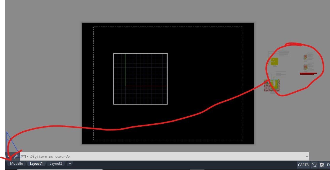

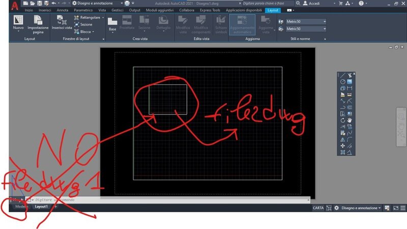

I went into layout I opened a window. I inserted a drawing with Xerif. I don't see the drawing inserted with xerif in the window?
We seem to be going in circles do you understand how the mview command works ?

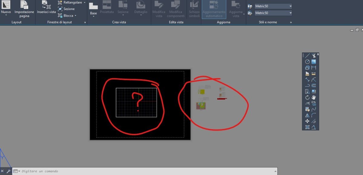

You go to model space and do xref put it somewhere.
Go to a layout be in paper space type pspace, then do mview make a viewport, double click to go into that viewport, then type ZOOM E, you will see the xref. Yes you need to set to correct scale or zoom in on xref. Type pspace, to go back out.
If you do not understand you need to get some one to show you how. Or look for youtube's re using layouts.

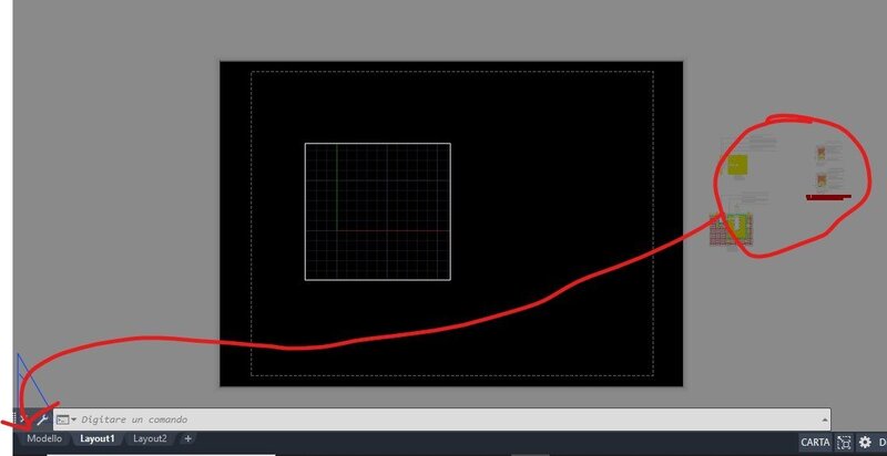

The Xerif I have to insert in the Model space and not in the paper space that is in the layout, otherwise in the Window I do not see the drawing?
I am sorry but not often I give up you need to talk to someone not here, do you know some one who uses CAD get in touch with them and have a one on one session, use ZOOM, Ms Teams and so on. You are struggling and it may be a language problem.

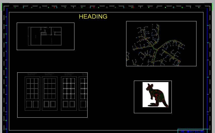

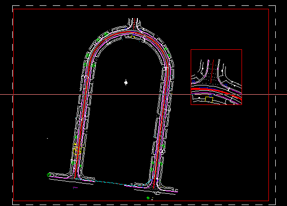

This is 4 seperate dwg's as xref's in one layout. All dwg's saved in Model, then viewed in layout.

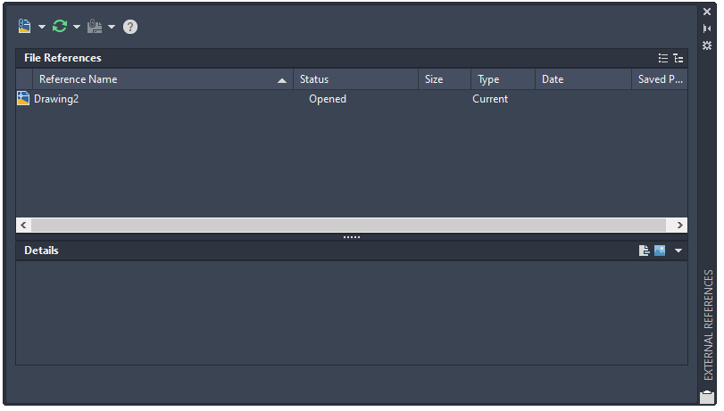

Use the command 'xref' in the command line (for AutoCAD, other programmes might have different commands) and this will bring up the following dialogue:
The drop downs at the top are the controls you want to use. The right hand button '?' is awesome......

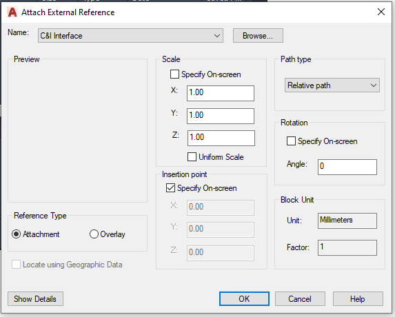

To insert an xref you want to select the left hand drop down to get this:
and now you can select one to attach the file type you want - follow the prompts to select your chosen file and then you should get this:
Here the thing you want is select Insertion Point, and generally "Specify On-Screen" to click what to use, though you might have an origin for the drawing in which case you can also enter an insertion point. Click OK and you should see your screen with a thumbnail, small version of your drawing at the mouse pointer, right click to insert it where you want.

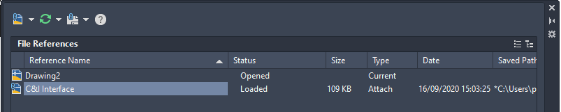

Your xref pallet will now show the file you inserted, in my example C&I interface:
Have a go at this and try a few test drawings adding in xrefs, or several xrefs to each.
Each XREF can be seen as a CAD object, like a block, it can be moved about, appear in viewports and so on, all the layers in the xref will appear in your layer list - generally with the layer name suffixed with the file name, you can operate these like any layer (turn on and off, freeze and so on)
