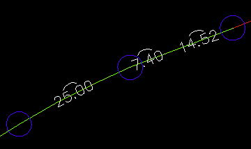

@Engineer_Yasser updated your code to work with polylines longer then one segment. Then I noticed depending on the zoom some dims might not be created. particularity the 7.40 and 14.52 .  updating to visual lisp and not using command fixes this issue and should make it run faster.
(defun c:test (/ sel myent bulg i p1 p2 mid a r c)
  (vl-load-com)
  (vla-startundomark (setq doc (vla-get-activedocument (vlax-get-acad-object))))
  (setq mspace (vla-get-ModelSpace doc)) ;forgot this line
  (if (setq sel (ssget '((-4 . "<AND") (0 . "*POLYLINE") (-4 . "<>") (42 . 0.0) (-4 . "AND>"))))
    (foreach MyEnt (vl-remove-if 'listp (mapcar 'cadr (ssnamex sel)))
      (setq bulg (mapcar 'cdr (vl-remove-if-not '(lambda (x) (= (car x) 42)) (entget MyEnt))))
      (if (/= (cdr (assoc 70 (entget MyEnt))) 1)
        (vl-remove (last bulg) bulg)
      (setq i 0)
      (foreach seg bulg
        (if (and (/= seg 0.0)
                 (setq p1 (vlax-Curve-GetPointAtParam MyEnt i)
                       mid (vlax-Curve-GetPointAtParam MyEnt (+ i 0.5))
                       p2 (vlax-Curve-GetPointAtParam MyEnt (+ i 1))
          (progn  ;pulled from here http://www.lee-mac.com/bulgeconversion.html#bulgearc
            (setq a (* 2 (atan seg))
                  r (/ (distance p1 p2) 2 (sin a))
                  c (polar p1 (+ (- (/ pi 2) a) (angle p1 p2)) r)
            (vla-AddDimArc mspace (vlax-3d-point c) (vlax-3d-point p1) (vlax-3d-point p2) (vlax-3d-point mid))
            ;(Command "_.DIMARC" MyEnt "_non" mid "_non" mid)
        (setq i (1+ i))
  (vla-EndUndoMark doc) ;and this line

Thanks For the help ... the 1st code worked too slowly and at the end stopped randomly before finish
the 2nd code is too fast and accurate .. I loved it but it's MText, not dimension. I need it dimension plz

I got an error when running the code as shown below
 error: bad argument type: VLA-OBJECT nil
As @mhupp points out, using (vla-AddDimArc) and (vla-AddDimAligned) will be faster.
Here is the code (I should have done it before)
Dim_PolyArc.lsp
  • Agree 1
left out defining the mspace. should work now.
; error: lisp value has no coercion to VARIANT with this type:  (433828.0 2.92447e+06 0.0)
Bricscad didn't need the "(vlax-3d-point" but i guess autocad does

Thanks a lot .. this code worked fast and clear

Thanks For Help ...
Perfect Code .. combined both codes and worked for Polyline & curved Polyline  🤩
