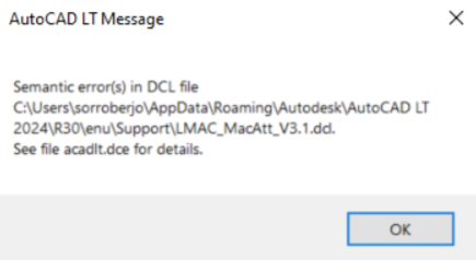

CafeJr Posted September 27, 2023 Posted September 27, 2023 Hello All, LT 2024 actually works with LISP, but we got some restrictions, as a Lisp using .dcl (pop-up menus): Below an error log trying to use it. Inside of it: Error in "select". (widget type = ** undefined **, key = "") Widgets of this type cannot have children. Someone knows how to solve it? Quote
BIGAL Posted September 27, 2023 Posted September 27, 2023 (edited) There are limitations with LT lisp and more code is popping up as not working, this is because its not a full version but rather what will we give them, compare say Bricscad and it works. It needs bits of the code to be tested, I am guessing and this is one bit of code to test. I am sure there is numerous other pieces. In most cases a different method can be used. (defun LM:ObjectDBXDocument ( / acVer ) I am pretty sure OBDX is not supported so can not look inside other dwg's. Explain more what your trying to do as using a script may be a way around the problem. ie open dwg1 Edited September 27, 2023 by BIGAL Quote
