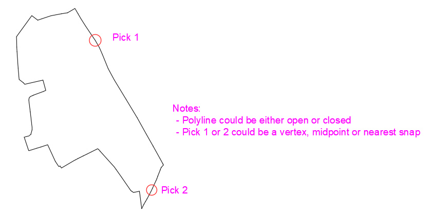

I was looking to see if there was a trace polyline routine to pick a vertex of an existing polyline and pick a 2nd one along it to trace over it. No point in reinventing the wheel 😉
I guess if it's a closed polyline then there would need to be a choice for the direction of the new traced polyline.
See the example drawing attached.

You might need to first activate END, MID, NEAREST in osnap settings  (Command OS)
Then (osnap) is what you're looking for.
Happy with this?

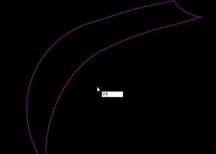

Hi @Tsuky, see the attached gif. I was wondering if is it much work to get it to work with arcs in POLYLINES? I wouldn't know where to start to get it to work. Thanks.

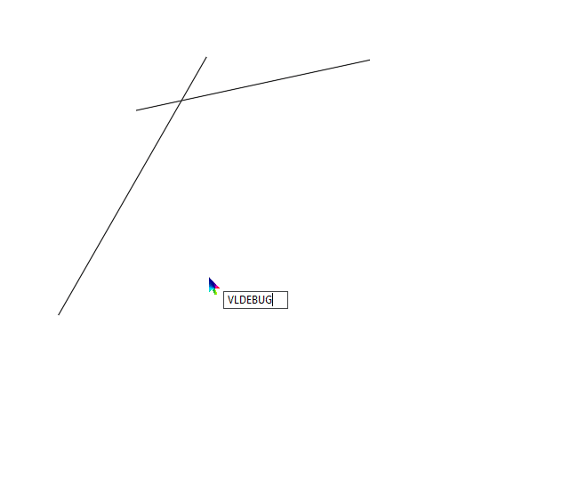

Thanks @Lee Mac. What I love about Tsukys' is how you don't have to pick any Polyline and it allows the trace to go over multiple Polylines. But it's not without the arc issue or finding any intersections like below.
I'd give anything to know how to fix these. I messed about with the snap for the variable pt_sel  with the below to try to fix this but nada.
EDIT: Looking at your http://www.lee-mac.com/grsnap.html atm. Seems like it could do what I want. Not sure though 😆

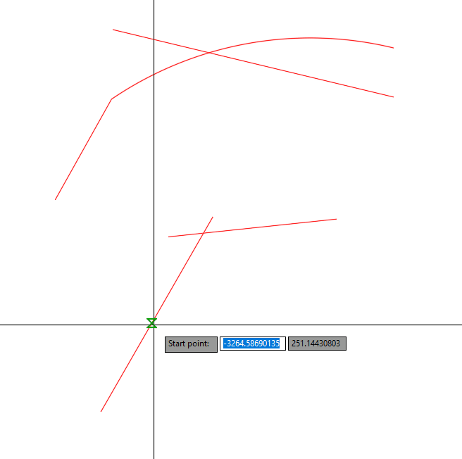

Back to square one, sort of. Getting different results. Tried my best to incorporate the LM:grsnap:snapfunction function but it sort of taught me something. This level of coding is above me.
Anyway. Here's the trace and the code below. I've commented where I'd added stuff with ;; 3dwannab Edit
