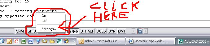

Right click on GRID and click SETTINGS

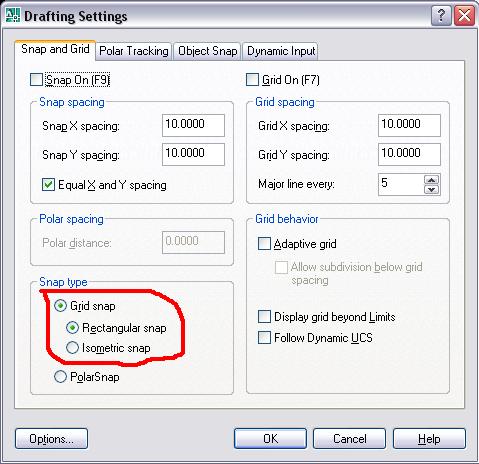

Set your Grid to ISOMETRIC snap
Use ellipses to draw ISOCIRCLES, while using
the F5 Key to change between left, right and top
face drawing.
