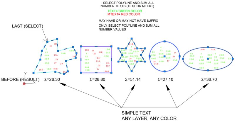

Greetings. I need your help. I have two Lisp routines that I found in these forums, one that selects texts or multitexts inside a closed polyline and another one that adds numeric texts. Currently I do both processes: first select and then add. I want the two routines to join so that with a single command I get the desired result. thanks for your attention and help me. I am not a programmer and I don't know how to do it.

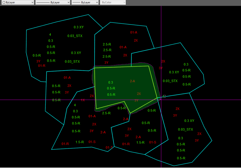

Thanks for the answer Bigal. To select the text enclosed in polygons I use two routines, "SWC" that select all the texts or mtext. enclosed in a polygon, circle or ellipse, done this action, I load the command "STN" to add all the numeric text. But I want the add action to be executed with a single process.

THANKS FOR YOU HELP.  THE FUNCTION OF SELECTION OF POLYGONS BY WINDOW OR CROSSING CAN BE ADDED. IT WOULD BE USEFUL TO SELECT POLYGONS THAT ARE NOT ISOLATED OR THAT ARE ATTACHED TO MORE POLYGONS.

This is a mod to  Mhupp code.
; Original code by Mhupp
; Modified by AlanH April 2023
; sums text inside plines circles and ellipse
;; ssget "WP" doesn't work well with polylines with arcs. This fixes it.
;(defun C:sumtext ( / obj v i ii x bulge seg lst cir div seg dist ANG ANGSEG CEN CO-ORD CX CY ENT HT J PX PY SS SS1 SS2 TOT TXT WID)
(defun C:sumtext ( / )
(setq SS (ssget '((0 . "*POLYLINE,CIRCLE,ELLIPSE"))))
