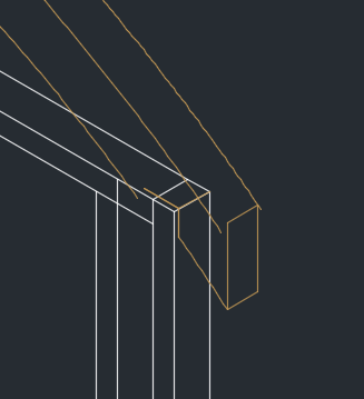

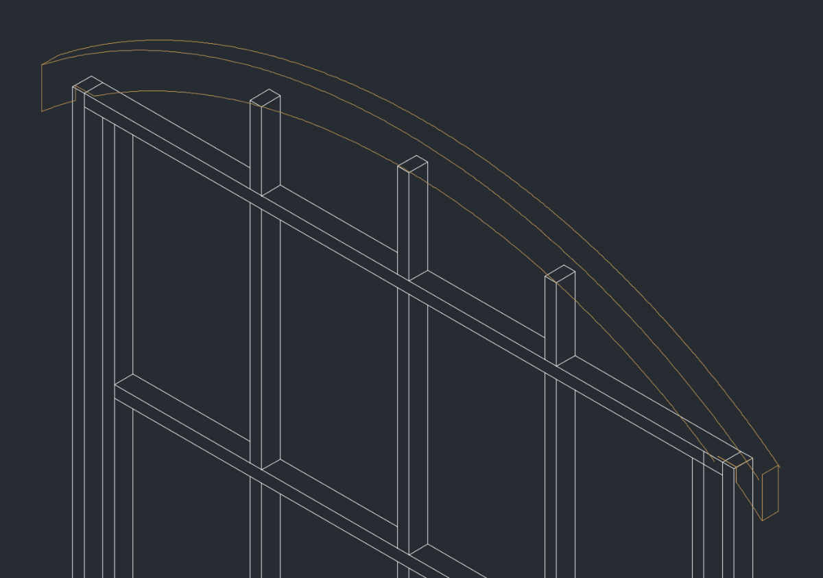

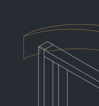

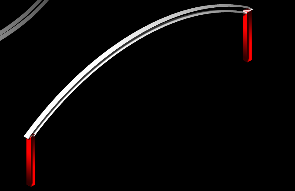

I’m designing a summer house with a curved roof for a local group. I’m doing several isometric exploded views of the roof construction, I have drawn the curvature of the roof by drawing an isometric circle and then trimmed to suit. I’m now trying to stretch these segments of the isometric circle but all I seem to be able to do is move each of the lines.
Any ideas on how to modify these segments of the isometric circle so they can be stretched?
Because a picture is equal to a thousand words I have attached 3 screenshots.
You will see in screenshot 2 why I want to do this.

I haven't done much work with isometric curves, but I think they are built out of ellipses, and they are constricted to a plane. That's why you can't move them.
Is it possible to move the other objects to fit the ends of the curve? That's like painting your bullseye around the hole, but sometimes you have to do that in AutoCAD.

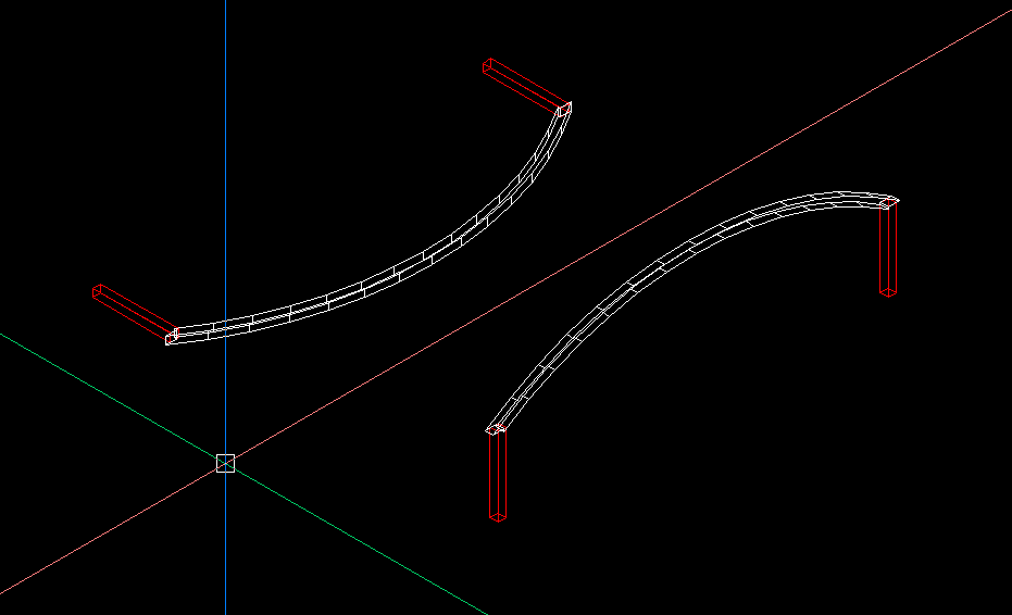

Why not draw in 3d look into thickness, Can draw all in plan add thickness to member say 100mm.
5 minutes work
making the arch a solid would be better if it was a UB then extrude along path.
Oh Yeah big hint ROTATE3D.

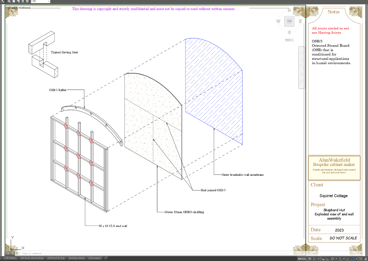

I got it sorted by drawing it from the roof down and in exploded view.
