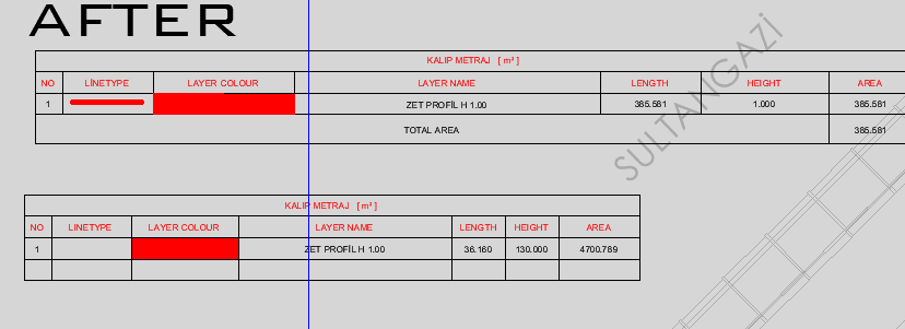

@hmtpk Please could you upload your list with the modification you did?
I made some modifications but I do not know how to set the cell at column 2 to show the LINE with  it's LINETYPE

You can set background color & insert a block into a cell, not sure about a line in a cell.
May need to get the properties of the cell somehow, the box values and just draw a line. It may need to be worked out from 1st principles like row & column size values. The title row can be made bigger than the data rows.
The top left corner is the table insert point, you picked so the X and -Y from it to work out where a line would be drawn.
y =pty - (1st height+row height+1/2 row height). Next row subtract row height from y.
x1=ptx + col 0 width+say2
x2=ptx + col 0 width+ col 1width - say 2
This should match you table
Post the updated code that you said did not work. It is better to see what was wrong and make corrections, then you learn.

@BIGAL The code is as I put , you can see I comment this line
;;;(vla-settext objtable  row 1               )
because I can not get the way to put a LINE at ROW and column 1 .
As it is show here.
It have no error , just a way to put a LINE at that CELL
I think a option to put a TEXT "___________" by underscore and then justify to fit a the cell center
(vla-settext objtable  row 1   "___________"            )
table with text as LINE.dwgFetching info...

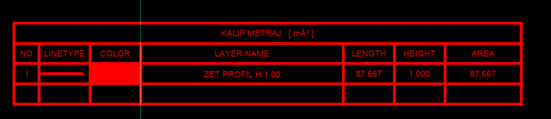

(defun ahdodrawline (llayer crow lcol / pt pt1 pt2 vdist acm )
(setq pts (vlax-safearray->list (vlax-variant-value (VLA-GETCELLEXTENTS objtable (+ crow 1) 1 :vlax-false))))
(setq pt1 (list (nth 0 pts)(nth 1 pts) 0.0))
(setq pt2 (list (nth 6 pts)(nth 7 pts) 0.0))
(setq vdist (/ (- (cadr pt1) (cadr pt2)) 2.0))
(setq pt1 (mapcar '+ pt1 (list 10.0 vdist 0.0)))
(setq pt2 (list (nth 3 pts)(nth 4 pts) 0.0))
(setq pt2 (mapcar '+ pt2 (list (- 10.0) vdist 0.0)))
(command "line" pt1 pt2 "")
(command "chprop" (entlast) "" "la" llayer "")
(setq acm (vla-getinterfaceobject (vlax-get-acad-object) (strcat "Autocad.AcCmcolor." (substr (getvar 'acadver) 1 2))))
(vla-put-colorindex acm lcol)
(vla-setcellbackgroundcolor objtable row 2 acm)

Thank you for your interest, Mr. Bigal. Lisp works, but as you said, it only shows 1 layer. Is it possible to see all layers in the table at the same time?
Post a dwg with multiple layers I think there is a bug in the original code not what I added.
Bigal Bey, the project with more than one layer is attached. The last code you posted was not subtotaling the fields.

Wiil have a look I only added color and linetype so will see what original code does on a multi layer dwg. It may be totaling column 5 instead of column 7.
Updated code please try.

(defun ahmktable ( numr / colwidth numcolumns numrows rowheight sp vgad vgao vgms)
(vl-load-com)
(setq sp (vlax-3d-point (getpoint "select point for table")))
(Setq vgms (vla-get-modelspace (vla-get-activedocument (vlax-get-acad-object)))) ;
(setq numrows numr)
(setq numcolumns 7)
(setq rowheight 40)
(setq colwidth 200)
(setq objtable (vla-addtable vgms sp numrows numcolumns rowheight colwidth))
(vla-settext objtable 0 0 "KALIP METRAJ   [ m² ]"); TABLE TITLE
(vla-settext objtable 1 0 "NO")
(vla-settext objtable 1 1 "LINETYPE")
(vla-settext objtable 1 2 "COLOR")
(vla-settext objtable 1 3 "LAYER NAME")
(vla-settext objtable 1 4 "LENGTH")
(vla-settext objtable 1 5 "HEIGHT")
(vla-settext objtable 1 6 "AREA")
(vla-SetTextHeight Objtable (+ acDataRow acTitleRow acHeaderRow) 12)
(vla-Setcolumnwidth Objtable  0 50)
(vla-Setcolumnwidth Objtable  1 100)
(vla-Setcolumnwidth Objtable  2 100)
(vla-Setcolumnwidth Objtable  3 400)
(vla-Setcolumnwidth Objtable  4 100)
(vla-Setcolumnwidth Objtable  5 100)
(vla-Setcolumnwidth Objtable  6 150)

(ahmktable  (+ (length lst2) 3))
(setq voltot 0)
(setq num 1)
(setq row 2)
(setq i 0)
(repeat (setq x (length lst2))
(setq itlst (nth i lst2))
(vla-settext objtable  row 0 (rtos num 2 0))
(vla-settext objtable  row 3 (nth 0 itlst))
(vla-settext objtable  row 4 (rtos (nth 1 itlst) 2 3))
(vla-settext objtable  row 5 (rtos (nth 2 itlst) 2 3))
(vla-settext objtable  row 6 (rtos (*(nth 1 itlst)(nth 2 itlst)) 2 3))
;(alert "color is nth 3")
(ahdodrawline (nth 0 itlst) row (nth 3 itlst))
(setq num (1+ num))
(setq voltot (+ (* (nth 1 itlst)(nth 2 itlst)) voltot))
(setq row (+ row 1))
(setq i (+ i 1))
(vla-mergecells objtable (+ (length lst2) 2) (+ (length lst2) 2) 0 5)
(vla-settext objtable (+ (length lst2) 2) 0 "TOTAL AREA ")
(vla-settext objtable  (+ (length lst2) 2)  6 (rtos voltot 2 3))

Some areas are -ve are they meant to be added to total as a positive number ?
Edited by BIGAL
Mr. Bigal, your work has been great.congratulations.fields will not be added to the sum positive.now the lisp is working perfectly.if it is poyline in the project, it assigns it as a line to the linetype section of the table.polyline in the project and polyline in the table.can this be done?
It also resets the osnap settings settings. Can this be fixed?
Edited by hamit
Change this forgot to do it down at end of code.
(setvar 'osmode oldsnap)
Hello ; First of all, thank you for your attention. I still have the problem of closing the osnap settings when Lisp is running. Also, I request that the polylines in the orije be thrown into the table as polylines, not lines.
Mr. bigal. Can you help me with my latest writings?
