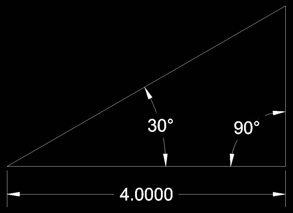

Has anyone written a routine that draws a simp le right triangle, given the base and degree?
in the attached drawing, I would like to enter 4" then 30degrees and have the triangle drawn.
If possible I could then place it using the mouse?
Thank you in advance!

hmmm...Error: Invalid parameter.
looks like its going to do exactly what I need.
I'm not sure where it throws the error but it happens when it asks me to place the tringle?

That is what I have, but it throws "Error: Invalid parameter."
I must be missing something

Works here:
Works fine here as well.
Nice LISP.
