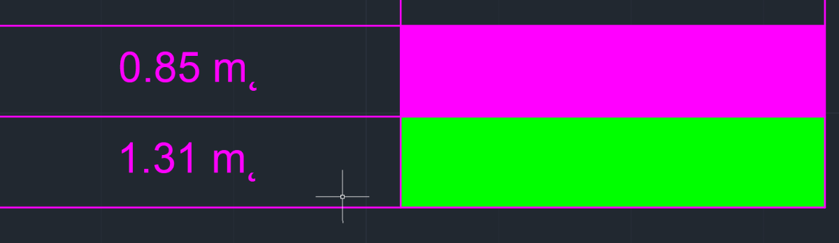

and did you do this to get squared?
(vla-setcellformat Area_table crow 1 (strcat "%lu2%pr3%ps[, m" (chr 178) "]"))
image.thumb.png.8452ffcc4aa4ed4932ad1b1afa09592e.pngIf i change like you did, i get this.
That's odd. if you create a piece of mtext, make a squared sign ( Â² ) in it and then paste that into the command line using (ascii ) that should give you the code to use, for me it is 178, or copy this into the command line:
(ascii "²")
For me its "72", but when I change all things according to your answer I get this error:
OK, This is what I have, should be the same as yours? Try it just to make sure of say typing errors and so on

It works perfectly fine now, thanks a lot sir.
Probably the type of annoying typing error that we all make then?
