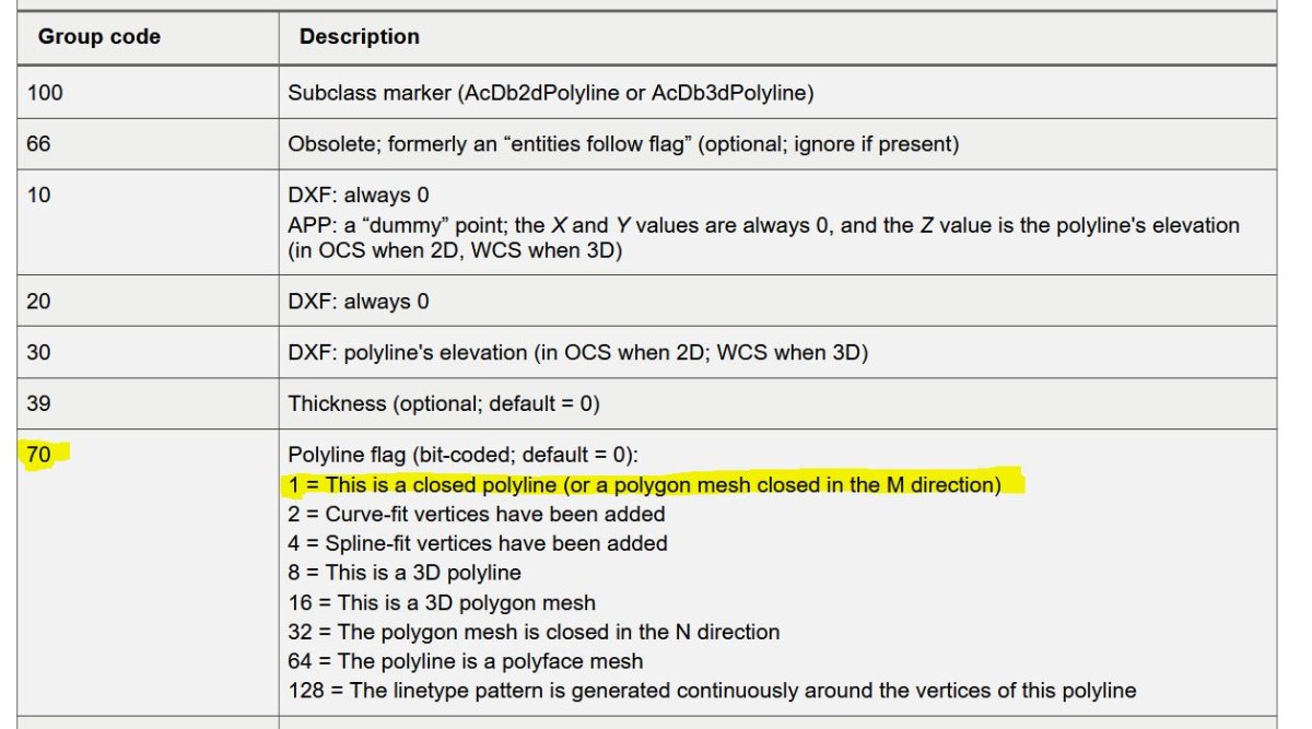

POLYLINE DXF Group code 70

Thanks but 70.1 will select only closed polylines. I need the opposite, to select only the ones that are NOT closed. One way would be to select all of them (by 70.0) and then filter out the closed ones (by 70.1) but I don't know how to do that. I am a lisp user, unfortunately not a programmer.

Thank you. I found some ideas there but finaly solved it like this:
(defun cgpolydesc (/ lst ss i en obj)
  (and (setq ss (ssget "X"
          '((0 . "LWPOLYLINE") ; object Name
            (-4 . "<NOT") (70 . 1) (-4 . "NOT>"); polylines NOT CLOSED
    (setq en  (ssname ss (setq i (1- i)))
      obj (vlax-ename->vla-object en)
You must prefered the bitwise "&" because you can have the bit typelinegen and closed (70 . 129)
