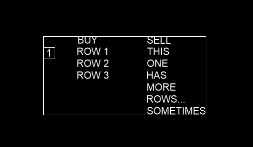

Compare 2 multiline attributes in same block, return number of lines from larger one
I'm trying to create a lisp that lines up multiple blocks in a legend. With one click it will space out the entire legend evenly.
The legend blocks contains a multiline attribute on the left, I believe it's attribute 2 and the one on the right is attribute 3.
Sometimes the left one has more lines, sometimes the right. sometimes they are both the same.
What would be the best way for a lisp to read both attributes and returning the max number of lines found? if both the same return one value.

This is a mockup file of the one I currently work with.
A program populates each block depending on buy or sells added to an addon program. Then there is a create BOM button that drops "these" in with really crazy spacing and I have to move them up to make it presentable. Sometimes a job consists of hundreds of these so you can just imagine how time consuming this is and the benefit of a lisp that can stack these .

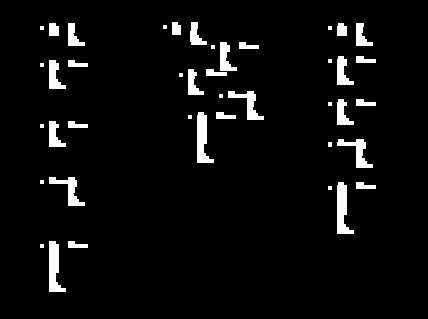

On a previous post,  https://www.cadtutor.net/forum/topic/76133-move-blocks-individually-in-y-plan/#comment-601479,  I was able to make a lisp where I cross select all items and then manually click one by one to put them into place. This greatly improved this process, but now I'm thinking, what if I avoid all but one click and have the subsequent items place themselves down based on the number of rows that the multiline attribute of the previous block has the most.

If I understand correctly use bounding box of a block to work out its size, make a list of block and box then just rearrange them.
Say sort on lower left point for order. Thinking about it.

Finally I did!
I know it's not pretty, and I'm sure I can delete a bunch of lines that are worthless, but I dare not touch something that is working perfectly!
Added a condition to check if xmatch is equal to X+1, this will make sure that I have to click somewhere for the very first item.
At the very bottom I setq point1 of the bounding box (I found this online so I left point2 just because it works)

My attempt

I decided to brave it out and start removing lines I don't need.
The part with the AlignBlocks I couldn't figure out how to get it to Y plane only, I had to add all 3 planes and pick Y through variables assignments as if someone was typing.
This is part of a much bigger code, but here is a working code stripped to just the alignment part.

(setq lst '()) this is one way to create a blank list or to delete an existing list, another is to use (append,  others will comment here about creating lists or resetting back to blank, I just reset in case already exists as I use LST all the time.
Did my code work for Y direction ? Yes can add X direction similar process just split code into 2 extra defuns a X & Y direction.
Complicated code No its not it uses a bounding box to find the extents of block, then works out the distance from the insert point to the top and bottom of the box so can work out where to move box to.
