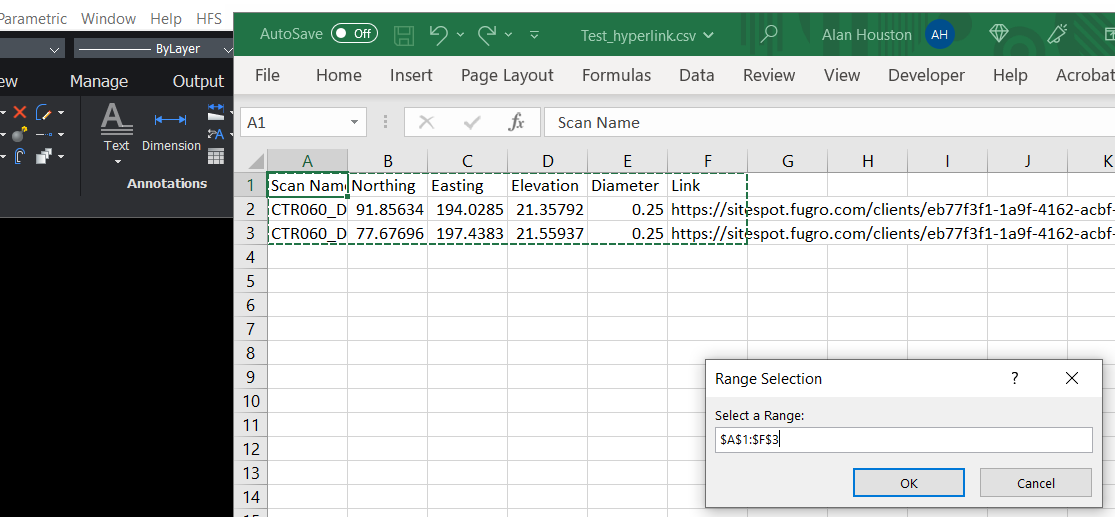

Devitg will give you an answer but you can also just read the cells direct from excel. Maybe Version 2.
In Autocad / Bricscad a list is returned
(("Scan Name" "Northing" "Easting " "Elevation" "Diameter" "Link")
("CTR060_DS02_001" 91.856336 194.028469 21.357924 0.25 "https://sitespot.fugro.com/clients/e.......")
("CTR060_DS02_002" 77.676962 197.438299 21.559373 0.25 "https://sitespot.fugro.com/clients/e......."))
If the excel is always the same 5 columns then can just go and read no need for selection. Start at row 2.

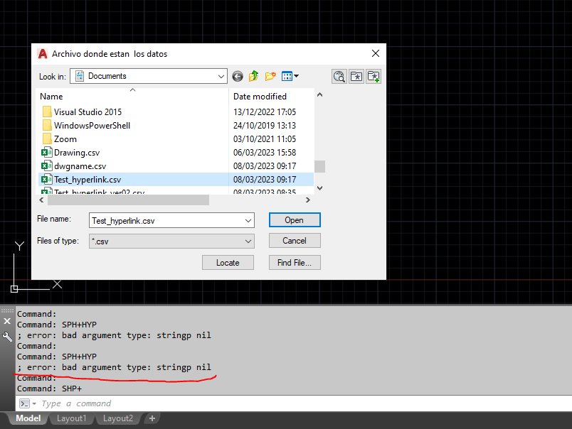

Hi Devitg, many thanks for your help regarding this issue.
After I run your lisp with command SPH+HYP and select my test excel csv. file in open window, I got message:"; error: bad argument type: stringp nil".
I tried to modify csv file but no success. Also, I use AutoCAD version 2017.
Not sure is problem on my part but, could you try to run my CSV test file with your LISP and let me know if it works on your side?
Thank you and best regards.
@Slobo_76  maybe it is  about the way your window system deal with comma separator.
change this part
(WHILE
    (SETQ LINEA (READ-LINE AR))
     (SETQ DATOS (STR-TOK LINEA ";"))
     (SETQ LINEA-LIST (CONS DATOS LINEA-LIST))
to
(WHILE
     (SETQ DATOS (STR-TOK LINEA ","))
I mean the ; by ,
i test it , and it work good.

CSV Comma separated values ? Yes Excel in some parts of the world uses the semi-colon ; as a separator. Been caught out before. Same with using a Comma "," v's a period "." in decimals 123.456 123,456
Edited by BIGAL
@BIGAL, yes here in my country, Argentina, some use , for thousands , and . for decimal , or any other combination  , according the software developer.
As follow 123.456,78 or 123,456.78 , and also 123456.78 or 123456,78
About CSV separator , once I saw a lisp that contemplate that possibility,  so it dig , not know where, to get the CSV separator used.
Think it should be at  operating system registry key  or what else .
