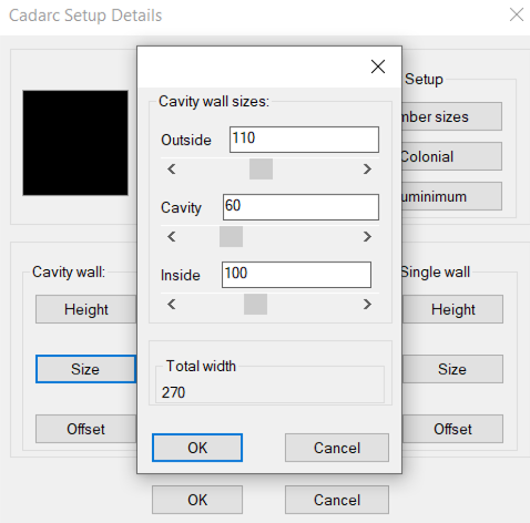

I have a piping utility which creates 3D components to insert into a model.
All works fine.
But, everthing is on a single dialog, appart from a child dialog for elbow bend radii.
I am considering changing the layout of the main dialog such that when selecting the item type to be created/inserted (radio button) the main dialog is closed to be replaced by a new dialog with just the relevant options for that selection. When selecting the OK button in the new dialog the item is inserted into the drawing.
Question:
Can this be done keeping all of the code in a single DCL file and single lsp file?
any hints/tips to get me started would be appreciated :)
SteveN
You can have a pop child dcl so when you select a dcl button the child is displayed the child can have grand children also. Is this what you want.
Hi Bigal,
NO, I already have a child dcl, here
What I am trying to achive is by selecting 'fittings' (in the above image) the current dialog is closed not hidden and a replacemnet dialo is opened/loaded which will contain ALL of the fittings options, so the greyed out options in the above image will not be presented to the user.
Here are the 2 dialogs (still wip)
I hope that makes sense.
Yes that is possible, you will of course need to define 2 dialogue boxes and so on. I'd make them dynamically - a part of the lisp file.
DCL as part of a LISP file can be made 2 ways, I'd go for create a temporary DCL file -somewhere- and each line use 'Write Line' some of the others define DCL in a list first and do a repeat loop to do the write line after that. Not sure if that makes sense what I am describing, the 2nd method might be a little more efficient and quicker but the 'write line' for each line allows you more scope to put in if statements and so the second DCL can be a bit more dynamic.
For passing the variables, you can set variables for each in the first dialogue, update the variable as the DCL is changed - and then when the DCL is closed the variables are retained and can be used to populate the next DCL. Close on the first can then open the second.
Something like that anyway
Sounds like you have no option but close the dcl and open the second but with correct items greyed out. When you hit Ok om second dcl it can reopen the 1st dcl if you need to do more. It may be better to just daisy chain the input so make all the dcl's little ones so do a next, next type of sequence rather than trying to do one big one.
I've made some progress, I have the second (child) dialog displaying and working, almost.
Still not able to turn off the original dialog.
can be seen in this image, In the backgound.:
In the action tile on the first dialog that calls the child dialog, I've tried:
;(unload_dialog dcl_id_m)
;(unload_dialog "dcl_id_m")
neither work.

what is the action code for the parent that calls the child? It should have a done_dialog, (done_dialog 1) I think
This is the code that opens the child dialog (NEST_FITTINGS)
 	(action_tile "s1"				 						;toggle Fitting options
		"(L1_ON)(L1_CLEAR)(L5_OFF)(L5_CLEAR)
		(RESET_LABELS)(RESET_DIMS)(RESET_LIST)(NEST_FITTINGS)
		(done_dialog DCL_ID_M)"			;(unload_dialog dcl_id_m)"		;(unload_dialog "dcl_id_m")"
	); END ACTION TILE
Done dialog didn't work without the " "'
with " " the parent dialog closed, but the child does not open!!

Quickly looking I have used a 1 in the past rather than dcl_id_m - have you tried that (I guess you have), another option is term-dialog which should close all dialogs then open the new one?
This works, almost!
 	(action_tile "s1"
		(term_dialog)(NEST_FITTINGS)"		;(unload_dialog "dcl_id_m")"
	); END ACTION TILE
The child dialog pops up and totally covers the parent dialog, identical size & position.
When selecting OK, the chosen fitting is placed as intended.
If you drag the child dialog to one side, you can then see the parent dialog.
Edited by sln8458
