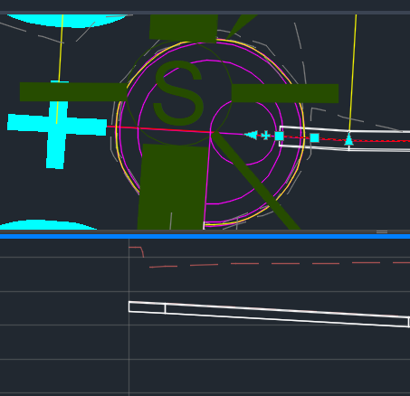

I'm having a similar issue, I have a pressure pipe network I want to add in the receiving manhole. The manhole will only show up properly if my pipe run alignment runs THROUGH the entire structure.  Which makes the pipe run through the entire structure which I don't want. (as show in the two snip inserts below) I am using Civil 3D v 2023.
 So my guess for your issue is the pipe run alignment running completely through the structure?  (but figure out how to trim back the pipe)
  image.png.c3719043f510d1dbbc4d21c771c140b9.pngimage.png.c81324e1158d995a775f8035ecc99a9c.png
