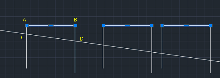

i want to know if there any method to project multiple polylines sides to another polyline
like the image for example
i want to lay the selected sides of this polylines to the inclined one
thank a lot my friends
Copy the 3 lines.
Scale them by the ratio of the distances CD/AB
Use align to position the scaled copies along the line passing through CD.
Or use trim!  Is there more to your question?

Copy the 3 lines.
thanks bro
align was the answer

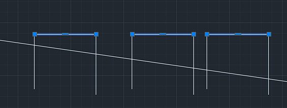

Do the vertical lines exist or are they there only to indicate the intersection points ? I ask as you can have just single lines and use the end points to make temporary lines that are vertical and as suggested "Intersectwith" does just that intersection of 2 objects.
