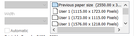

BIGAL Posted March 5, 2023 Share Posted March 5, 2023 (edited) Pretty sure did this, have you looked at setting up a custom sheet ? You work out the pixel size for the size of the plotted sheet at a DPI ratio so 36x200 would be 7200, 36" sheet at 200dpi, could try 300 etc. Â Edited March 5, 2023 by BIGAL Quote Link to comment Share on other sites More sharing options...
3dwannab Posted March 5, 2023 Author Share Posted March 5, 2023 Thanks @BIGALÂ but that would be difficult for everyone in the office to implement. Quote Link to comment Share on other sites More sharing options...
BIGAL Posted March 5, 2023 Share Posted March 5, 2023 Not really pretty sure custom size is stored in the relevant PC3 file. Copy to other pc's. Quote Link to comment Share on other sites More sharing options...
