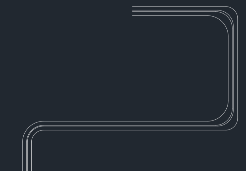

Rounding of 4 polylines according to the criteria:
- radii from inside 420 , 560, 588 , 728
- if the outer polyline becomes the inner then round 728,588 ,560, 420
The point is to detect with 4 polylines are next to each other, determine which is internal and which is external. Then for each polyline round the hatches alternately according to the above criteria.
Also i am looking for a way to sort polylines according to selection cords. Right now if i select every polylines clicking one by one its fillet according to selection but if i try to snap selection then its all messed up its going like 1-1 , 2-3  ,3 -4 , 4-2

Rn its look like that:

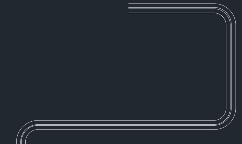

And i want to acheve this:
Are the images back to front as offset would do what you want. Are you trying to convert offset plines to have different radius as per image 1.
I want to convert offsets.
those are 4 seperate polylynes which i draw with code: (its modified code from someone from this topic)
