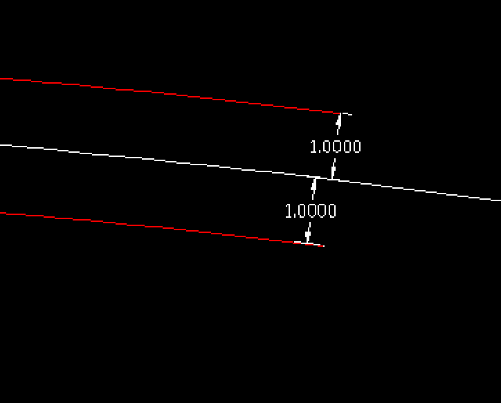

saunambon654 Posted February 24, 2023 Author Posted February 24, 2023 @devitg: Please find the sample DWG file attached. @Steven P: Yes, I (step 1) created a polyline, (step 2) copied it from (list 0 0) to (list 0 0), (step 3) broke new polyline at P1 and P2, and in the end (step 4) erased polyline out side. @Isaac26a, Steven P: Yes, I already checked it. If the LISP from Lee-Mac allows zero distance is perfect. I also could do until step 3 by LISP, but step 4 I do not know how to determine it. Copying part of Polyline.dwg Quote
Steven P Posted February 25, 2023 Posted February 25, 2023 You'll also want to change this line: (setq d (getdist (strcat "\nSpecify Offset <" (rtos *off*) ">: "))) to (setq d 1) Quote
devitg Posted February 25, 2023 Posted February 25, 2023 @saunambon654 Please give it a try Please report any error strip-poly.LSP 2 Quote
saunambon654 Posted February 26, 2023 Author Posted February 26, 2023 10 hours ago, devitg said: @saunambon654 Please give it a try Please report any error strip-poly.LSP 2.13 kB · 3 downloads Thank devitg, If the direction P1->P2 is same with polyline, it works fine. But if not, it does nothing with error: Command: STR-POLY select the poly Select objects: Pick first pointPick the second point_break Select object: Specify second break point or [First point]: Command: Command: STR-POLY Unknown command "STR-POLY". Press F1 for help. Command: _break Select object: Specify second break point or [First point]: Command: Command: STR-POLY Unknown command "STR-POLY". Press F1 for help. Command: ; error: bad argument type: VLA-OBJECT nil Command: and one small thing: the BREAK command (VL-CMDF "_break" POLY-ENT P1 P1 "") should be (VL-CMDF "_break" POLY-ENT P1 P1). Quote
saunambon654 Posted February 26, 2023 Author Posted February 26, 2023 16 hours ago, Steven P said: You'll also want to change this line: (setq d (getdist (strcat "\nSpecify Offset <" (rtos *off*) ">: "))) to (setq d 1) I did not understand your idea. This is the result after (setq d 1). Could you explant some more detail? Quote
saunambon654 Posted February 26, 2023 Author Posted February 26, 2023 On 2/25/2023 at 12:01 AM, Isaac26a said: Maybe this one of lee mac can help you. Isaac26a, the calculation from Lee-Mac is too complicated for me, I could not understand it. But I have idea: Can I offset a polyline with distance 1, and do it again back with distance -1? Quote
saunambon654 Posted February 26, 2023 Author Posted February 26, 2023 Thank you Steven P for your idea. I have improved the lisp from Lee-Mac. It also works for LWPolyline inside block with alternative NEnsel. Please take a look. Copying part of Polyline2.dwg PLP - Copying part of LWPolyline.lsp 1 Quote
