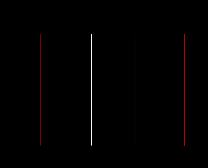

This routine was written by someone else, I don't remember and can't find who, if I could I would give them credit....
Could someone help me modify it?
The routine works perfectly, but I would like to change the direction it draws the polyline?

Change this:
(append (car l) (reverse (cadr l)))
To this:
(reverse (append (car l) (reverse (cadr l))))

So the 2 white lines are drawn in opposite directions, the red are the offset lines so how would you decide which way is always to right ?
Looking a bit more is this only for vertical Lines ? We need more info a dwg that shows wrong side.

Change this:
To this:
That worked.
