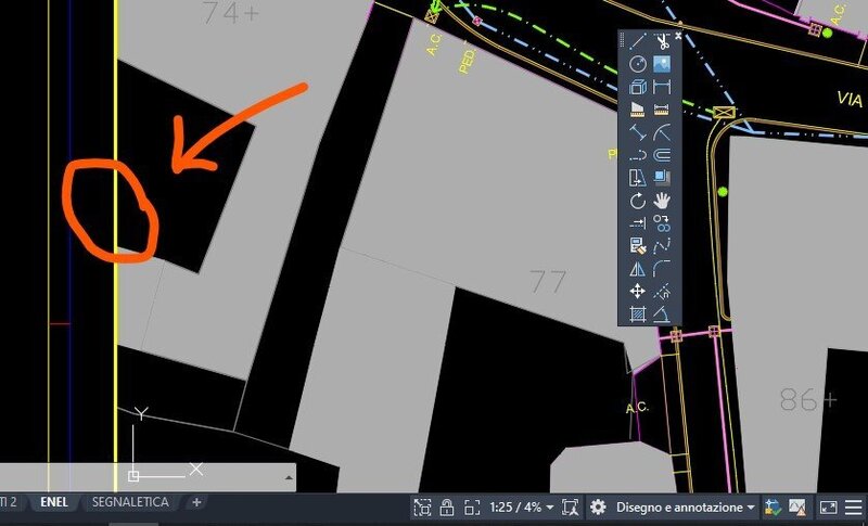

Giovannino60 Posted February 22, 2023 Share Posted February 22, 2023 To enter the layout to draw, click twice with the mouse inside the layout box and I can draw, to exit the layout box click with the mouse twice outside the box. Is there another command that lets me exit the layout pane? Thank you Quote Link to comment Share on other sites More sharing options...

CyberAngel Posted February 23, 2023 Share Posted February 23, 2023 In addition to the other suggestions, you can enable a button on the status bar for Model/Paper (in English). I don't see it on your status bar. When you are in paper space, it says PAPER; you press it and switch to model space. When you are in model space, it says MODEL; you can press it and switch to paper space. Quote Link to comment Share on other sites More sharing options...
