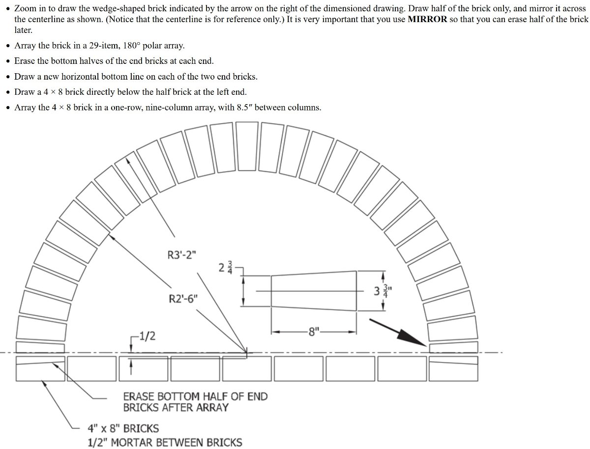

Hello,
First time poster here. I'm doing the exercises from the book "Discovering AutoCAD 2020" by Dix & Riley (I'm enrolled in Penn Foster and using this book but this is not a required exercise or project, just doing it for my own good). If you refer to the attached page below, it says to create the top half of an object, mirror it, and then create a polar array. After making the array, I'm to delete the bottom half of the object only on the extreme ends of the array. I know how to delete the the entire object(s) while leaving the rest of the array intact (ctrl + left click to select, then erase) but I don't know how to just erase part of an individual object and I've wasted too much time trying to figure it out. A workaround I found was to use the "explode" command (not yet introduced in the textbook) and then erase the bottom portion but this dismantles the array (and unless I'm mistaken, I can't "explode" just 1 object of an array). Another workaround I haven't tried but should work would be to delete the 2 extreme ends entirely and then redraw just the top half on each extreme end. But really what I'd like to do is what the book is telling me (3rd bullet point) I can do so I'm looking for some helpClipboard01.thumb.jpg.88c8a9dbe51d33638cd9dccb44696dd7.jpg

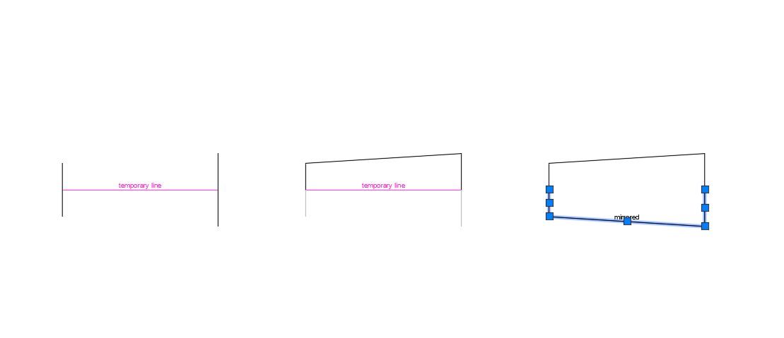

This is how I read to make up the brick, made from 6 lines:
For the edges I draw them at the full length and then trim them to the temporary line - just saves me doing the sums in my head, though I think the correct way is to half the length of each and draw them from a temporary centre line at the correct length

You are correct (actually you helped me notice that I had not deleted the temporary line prior to the array, so I remade it). The drawing is attached. So now I'm at the point where the array is made and I'm ready to delete those 3 lower lines. The problem is I don't know how (my attempts lead me to erase the entire object)
