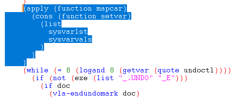

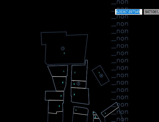

Good morning, some time ago they helped me develop a routine in which the areas of the polygons were calculated according to the data entered, for example polygons larger than 300m2, it works correctly for me, now I must add a table of areas of these lots found, identifying the apples to which they correspond as it is in the example, I hope you can help me, thank you very much.

In this routine the calculation of areas is done to 3 decimal places, it could be changed to 2 decimal places
polygons.dwg

Not tested, but see if you can use it... If something's wrong, I suspect at command tokens specified for (command) inputs - here (exe (list "_.command" "token1" "token2" ...))

(foreach data datalst
        (setvar (quote cecolor) (rtos (nth 3 data)2 0))
        (exe (list "_.TEXT" "" "_non" pt room "")); this line put the text strin "_non" att point (0 0 0 )
        ;; despite the pt variable hold (2012.55 1632.25 0.0)
        (setq room$ (vlax-ename->vla-object(entlast)))
        (exe (list "_.TEXT" "" "_non" (polar pt (* 1.5 pi) 0.5) (strcat (rtos area 2 4) " m²" "")))
             ;; despite the pt variable hold (2012.55 1631.75 0.0)
        (setq area$ (vlax-ename->vla-object(entlast)))
      );ends foreach
and when ask to select the point to set the table

Hi, when selecting the elements and clicking the insertion point of the box, the result is _non

Test it again... I've updated it once again... Please note that you must have boundary LWPOLYLINE(S) in corresponding Layer(s) representing various room(s) specification(s) - each Layer must have different color to become distinguished with each other... Added TOTAL row to TABLE...
Just saw your DWG...
You have parcel instead of room, so I've changed my code accordingly... If you find it useful, please give it a kudo, or solution so that we know that your request founded adequate answer...
Regards, M.R.

Hi Marko , first run at polygons.dwg return this error
Command line returns
Command: P-A+TBL
Regenerating model.
Regenerating model.
Regenerating model.
Regenerating model.
Regenerating model.
Regenerating model.
Command: AutoCAD variable setting rejected: CLAYER "0"; reset after error
Command:
Command:

It doesn't occur on my PC(s)... All my CAD(s) don't error at that place - it is my template sub for writing new stuff more reliably... Why would variable CLAYER reject "0" - it must be that you removed layer "0" which is default one... Although I read that "0" Layer can't be removed, I've seen during my carrier that on one DWG it didn't exist... Please return back Layer "0" and start routine exactly from that Layer... One more thing - my code is made for many different Layer(s) colored differently for DWG's far more descriptive than OP's posted one... Still, it didn't break on my BricsCAD V23, AutoCAD 2022 and BricsCAD V21...
